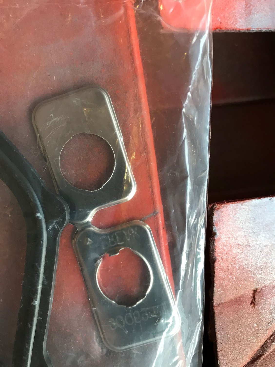

Also in the gasket kit came these metal pieces. Looks like they are some type of restrictor. What are they for and do I use them?
Heat cross over restrictors for center heat track.
