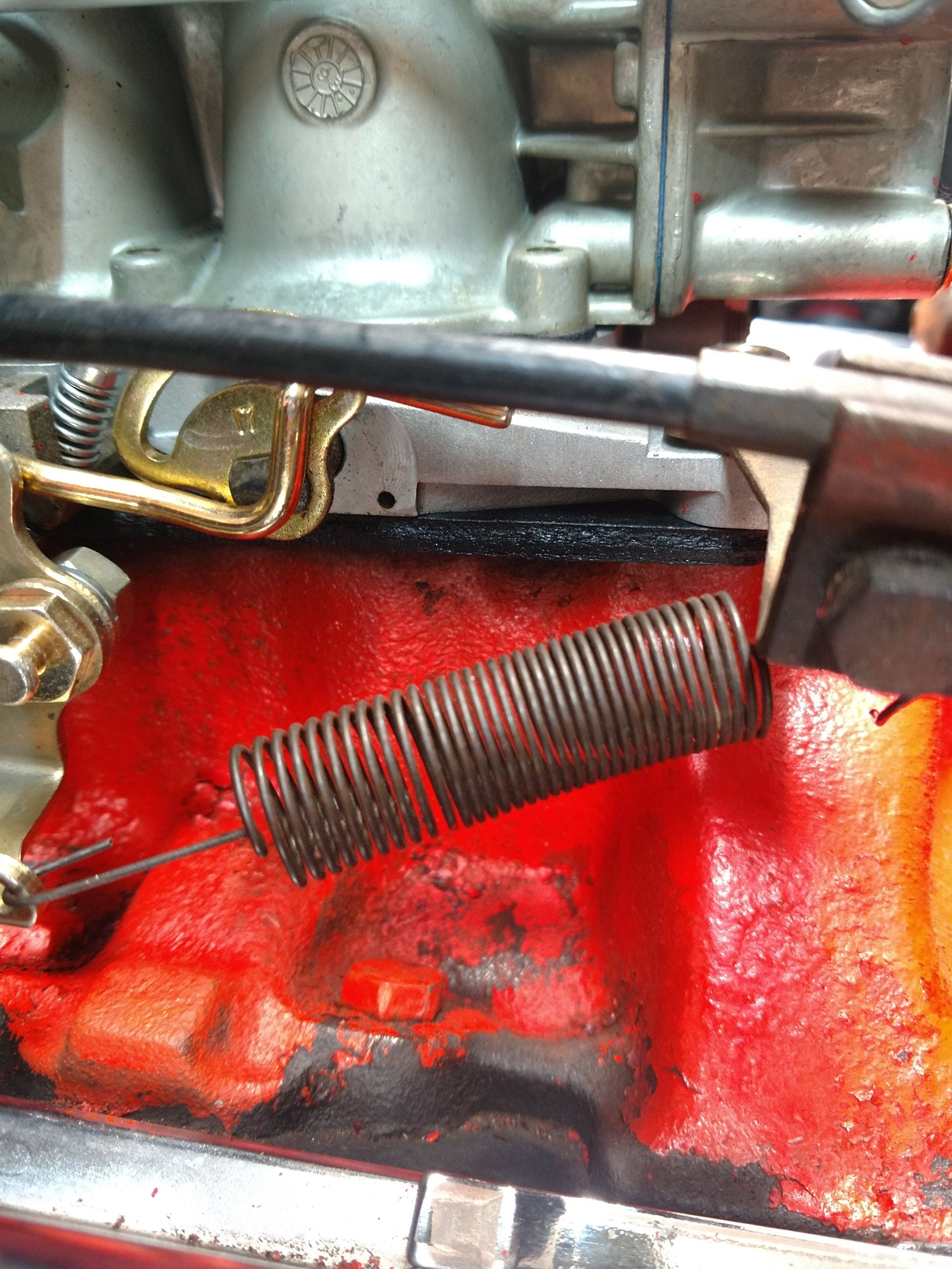

A pic of the base gasket. There isn't a fuel return line. I adjusted the float as per holley directions. The car runs very well after it starts.

I still firmly believe this is the problem. You probably have the 3919803 casting number intake manifold. It has an exposed heat riser passage across the front that ROASTS the front bowl on the spread bore carb on top of it. Pull the carb off and see the bottom for yourself. It will look like it was bolted to the top of a bar-b-que.
You will need a thin stainless steel heat shield for a Quadrajet to lay down on the intake first and then a new Quadrajent carb gasket on top of that at the minimum. You could just toss the crappy intake and go back with a nice lightweight aluminum intake. You just cant run it the way it is now.
