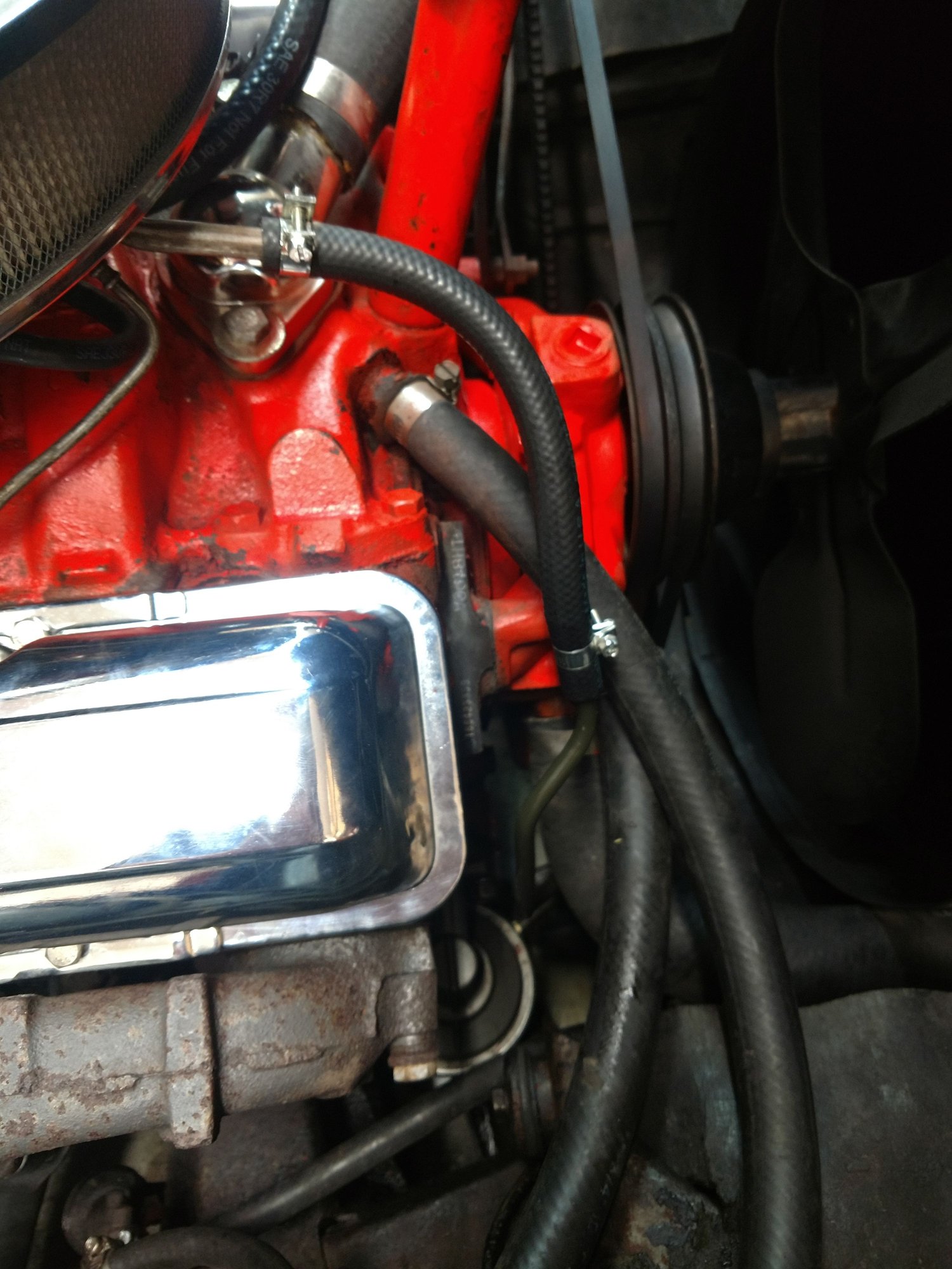

The choke is fine,, Pic of the fuel line. Not close to exhaust. You can see it running to the fuel pump.
