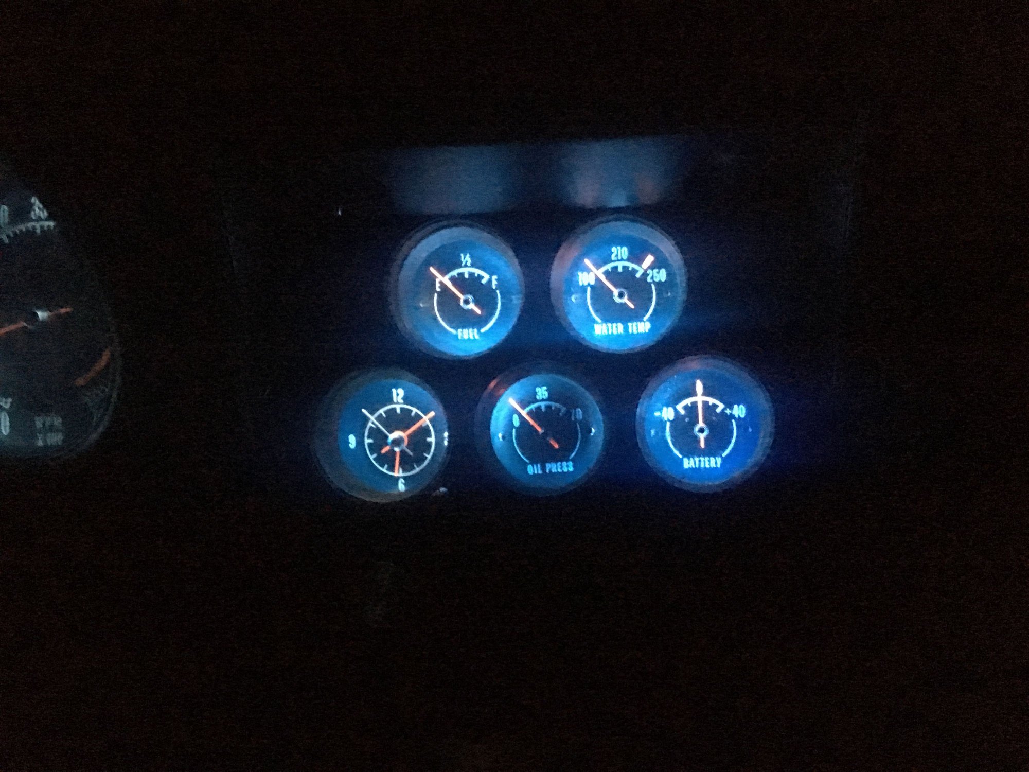

its been a while but I just took whatever the model number for the stock bulb was and searched ebay for the led version and used those... they have been working for a few years now.
mine looked like this but im not sure if these are the right model or not..
https://www.ebay.com/itm/2X-BA9S-Xen...wAAOSwrSpdNBR7
im fairly certain these are the ones I used,
https://www.ebay.com/itm/10pcs-BA9S-....c100005.m1851
they are brighter and blueish compared to stock.

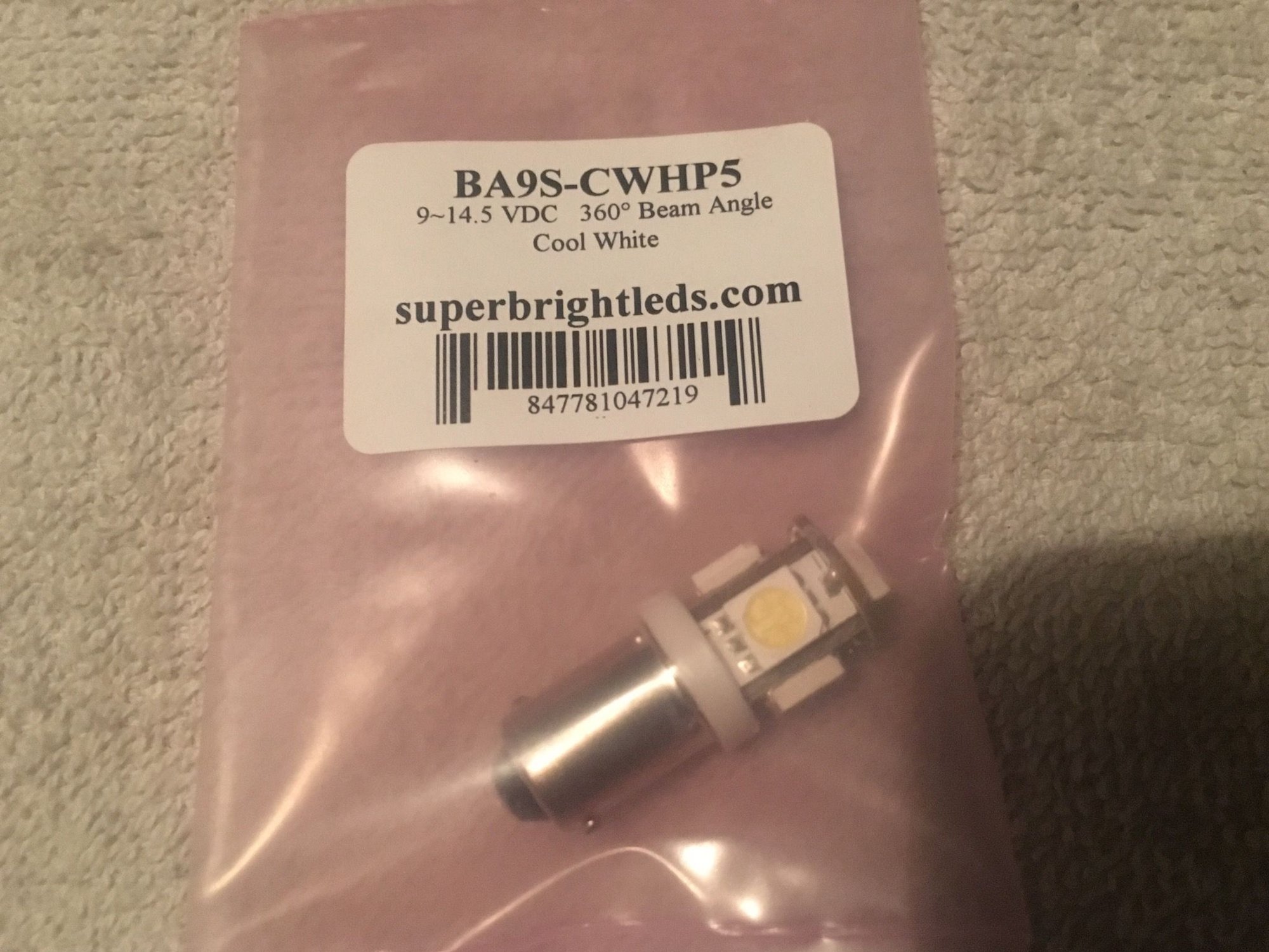

I ordered these from superbrightleds.com for my ‘72. They are the cool whites. They offer another white that isn’t as bright, as well as other colors. These particular bulbs are not dimmable, but they do offer others that are. I don’t ever use that feature, so it didn’t matter to me.

For the center gauge bulbs, my added tip would be to replace the sockets all (6) with 2-wire versions, and then join all the grounds together to a good ground source.
My issue was random flickering individual bulbs, and was always to due shaky grounding from those single-wire prongs to the back casing of the gauge cluster.
LEDs all burn nice a bright now, and 100% consistent!
