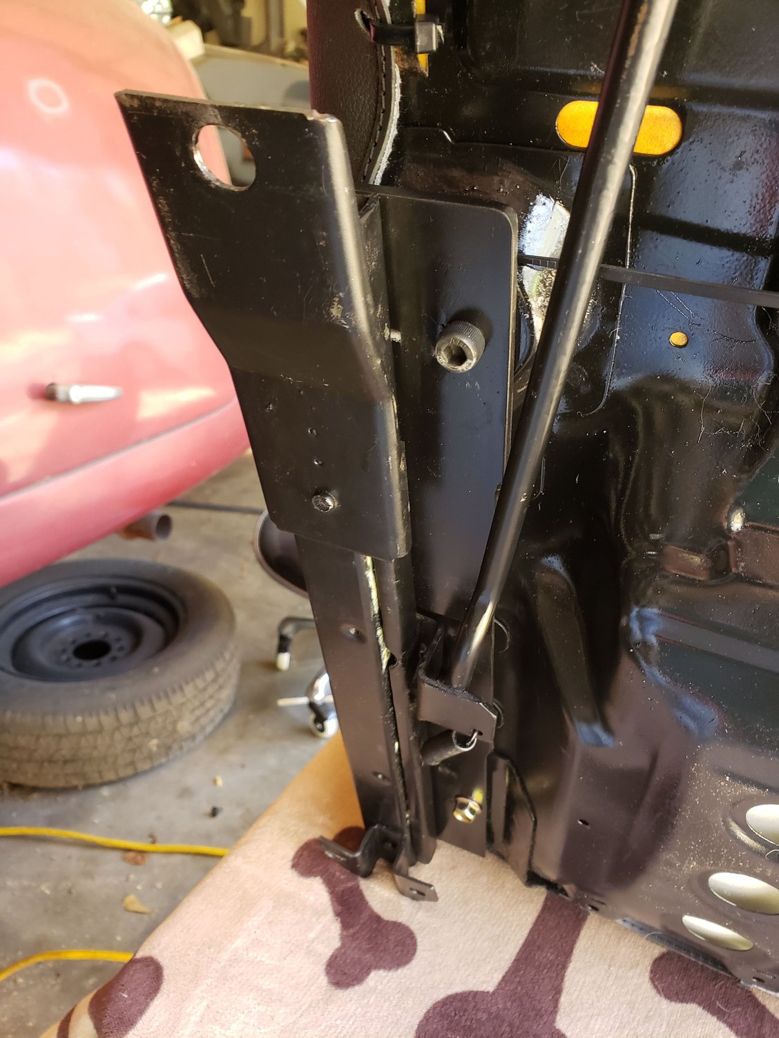

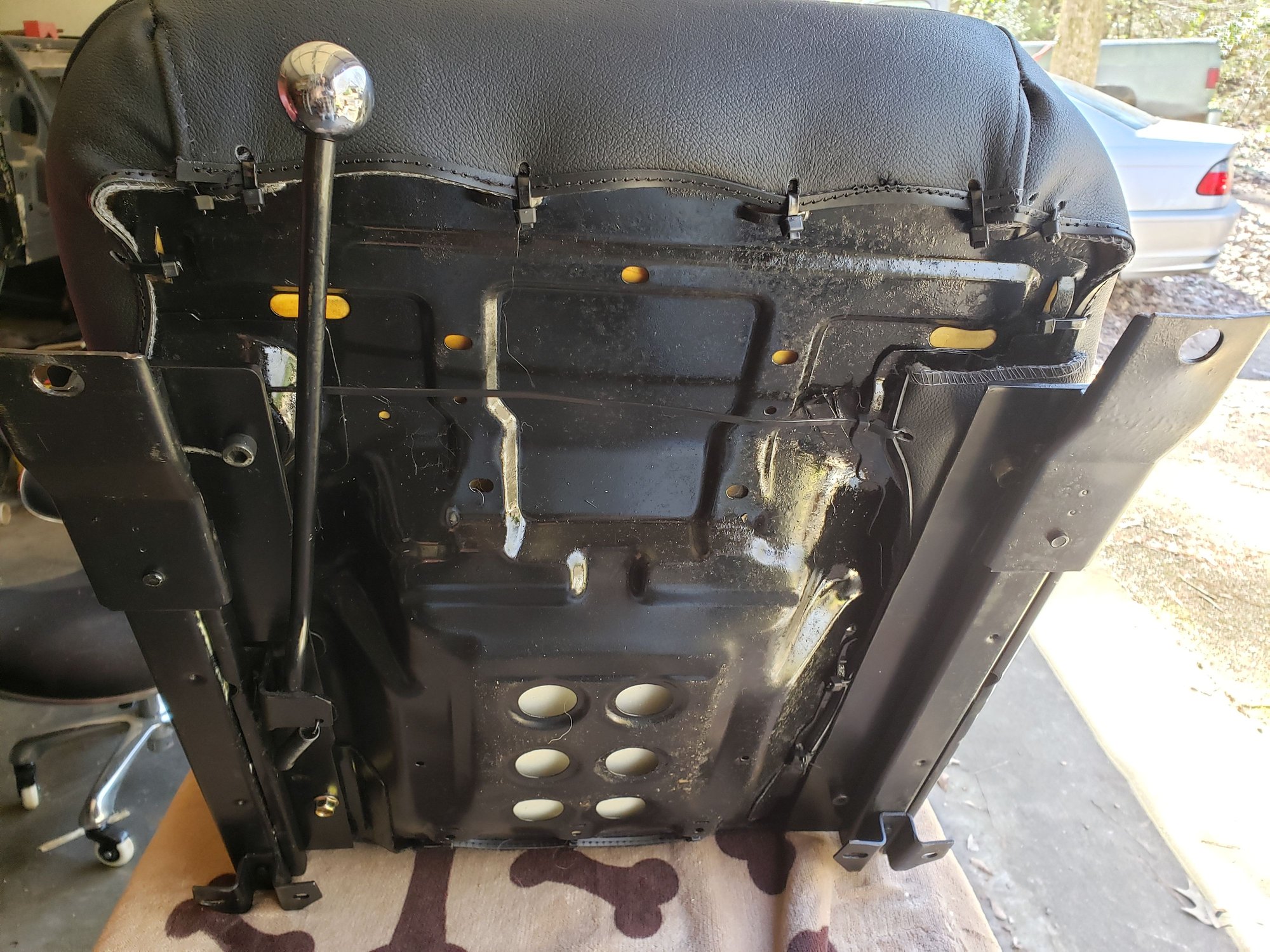

Originally Posted by Rob Via
gil7247 or others,
I am planning to go down the Fiero seat swap path myself. How did you do the bracket conversion? Is there a kit you can buy? Do you have to make something? I'm not a metal work guy. Drill and a skil saw is about all I have. I have a 1980 and I hope my interior can look close to this one day.
I went with Fiero seats also. This thread may help you out......https://www.corvetteforum.com/forums...t-project.html
