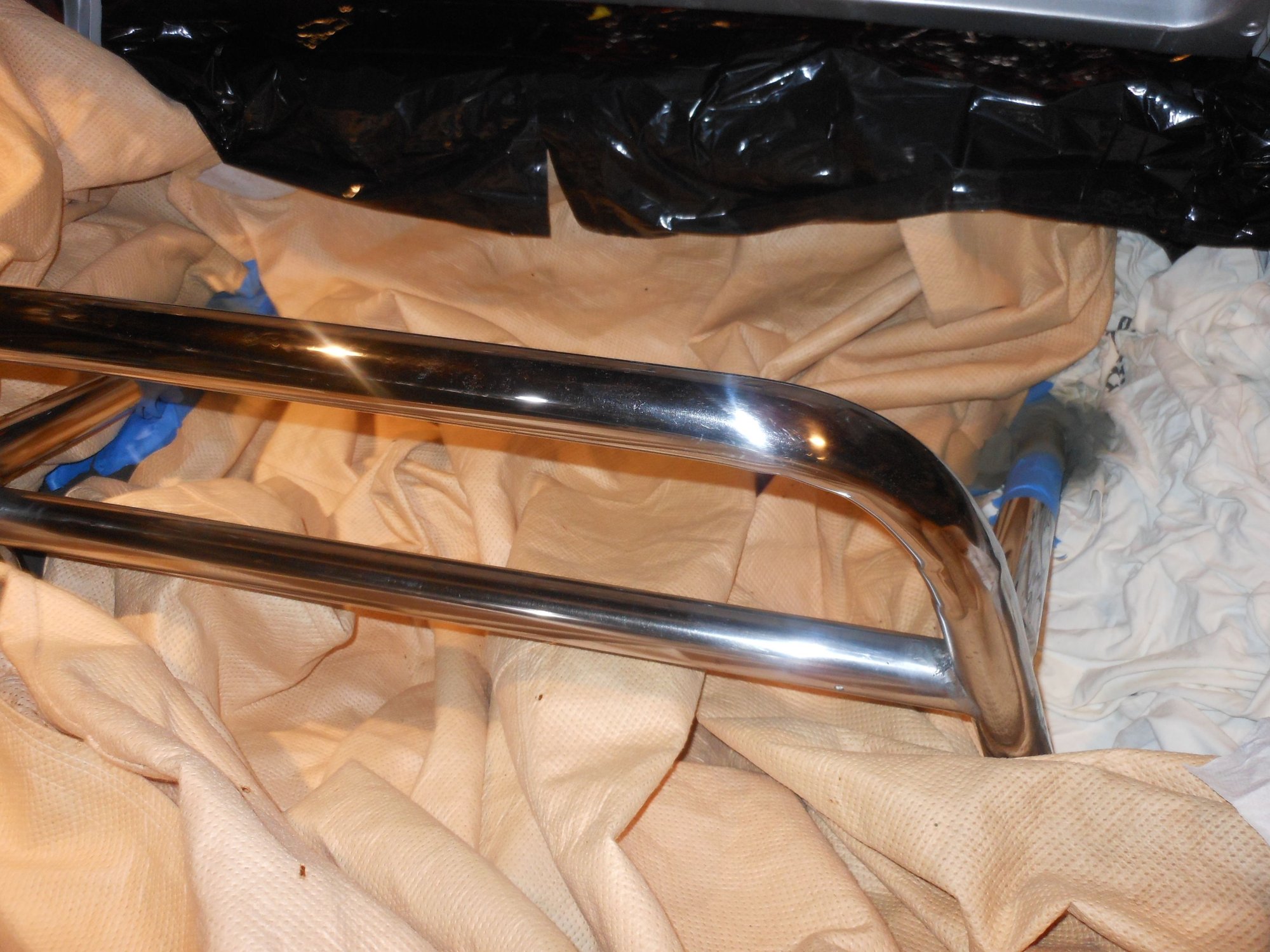

Use to be a simichrome fan-
I have polished a lot of stuff and have found that the Mothers Mag and Aluminum polish works the best and keeps the shine longer.
Everything from Dewitts radiator to the stainless sidepipes I made from 304 SS-
Left unpolished-
even did wonders on my chrome-moly rollbar!!!
Dewitts radiator- just look at the reflection of the neck
Dry sump oil pan
Everything from fuel injector rails -velocity stacks to the SS exhaust manifolds
