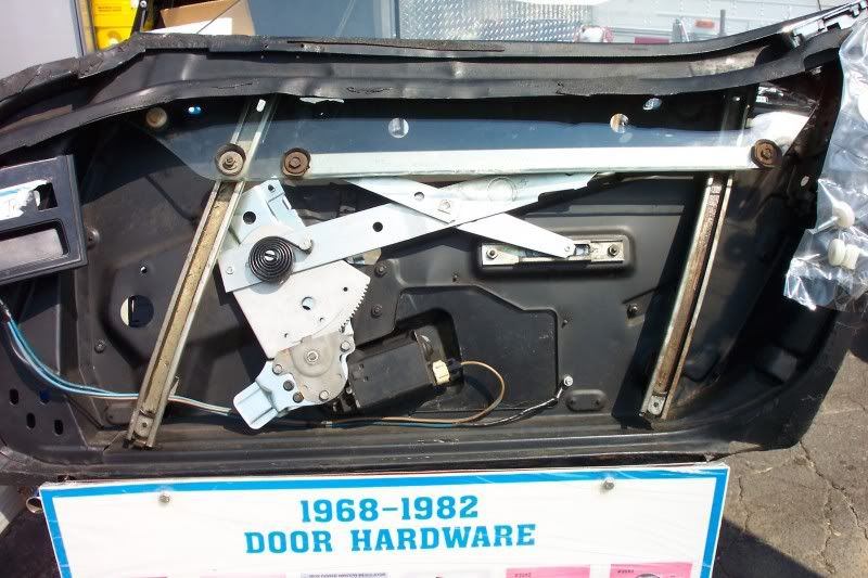

Not sure which roller you’re referring to, but maybe this picture will help.

in that pic, i *think* its the front most roller on the glass. the one that rides up and down the vertical track.

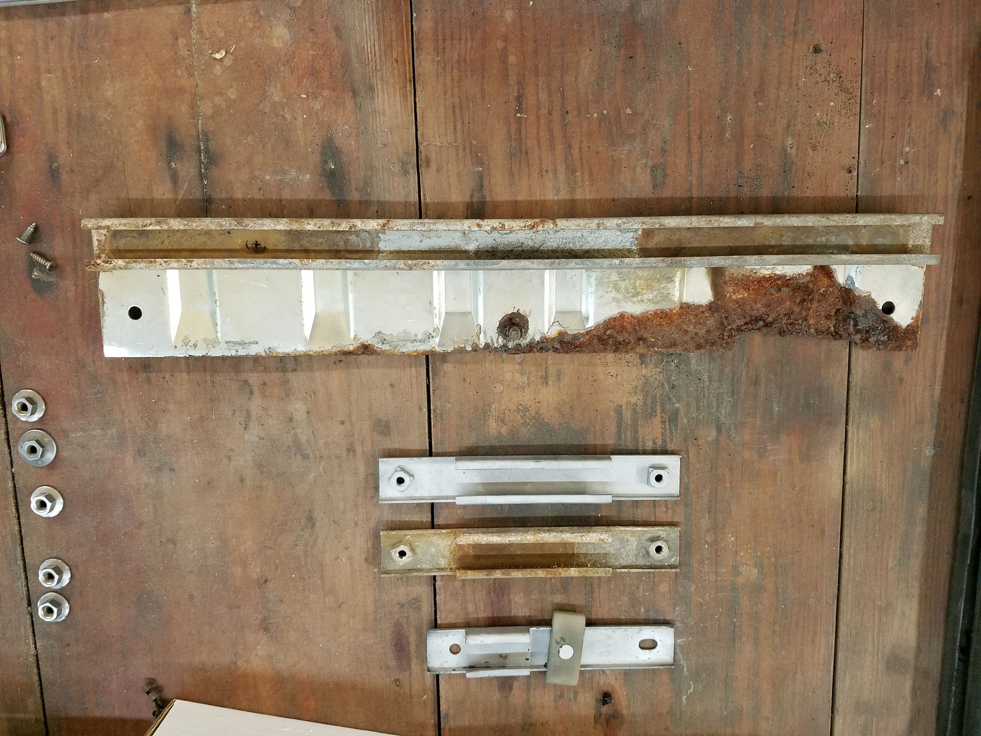

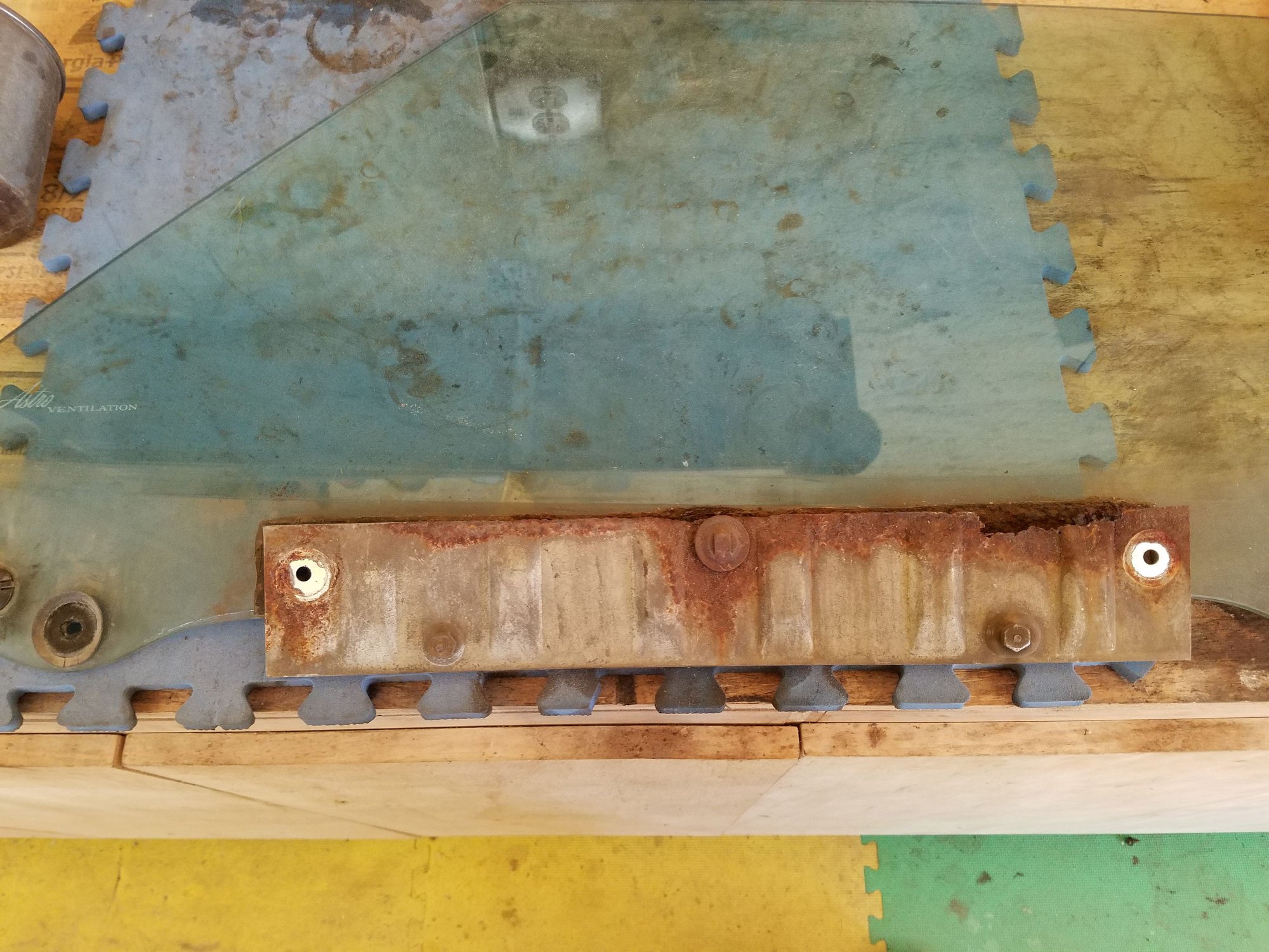

Your glass should also have a metal support attached to it. 68 and early69 had them. They often rust out in places. You can find them but I don't think they are being reproduced.
Need to be very careful when working the nuts and loosening thtu old glass
Some of the other parts. Not to bad a job.
To window roller
