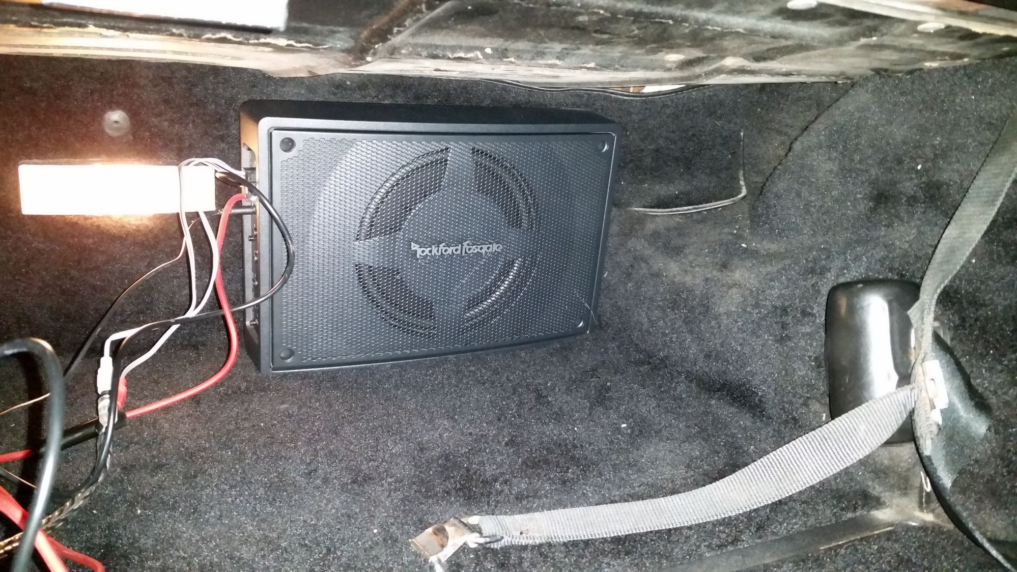

I've been pulling my hair out (what's left of it), trying to diagnose a problem where my sub-woofer cuts in and out without warning or pattern.
1969 Coupe.
Happens only when driving. All is fine when engine is off and it's running only off the battery.
It's one of those Rockford-Fosgate compact subs (PS-8) that I have mounted to the back wall of my rear compartment and wired directly to the battery.
Just today, on a nice Friday drive into work, I noticed that the sub cutting out seems to be linked to when my Volt meter jumps up to about 18V (I changed from a broken Amp meter last year). When the voltage comes back down to 15V or lower, the sub comes back on. Pretty consistent relationship, once I put my finger on it.
