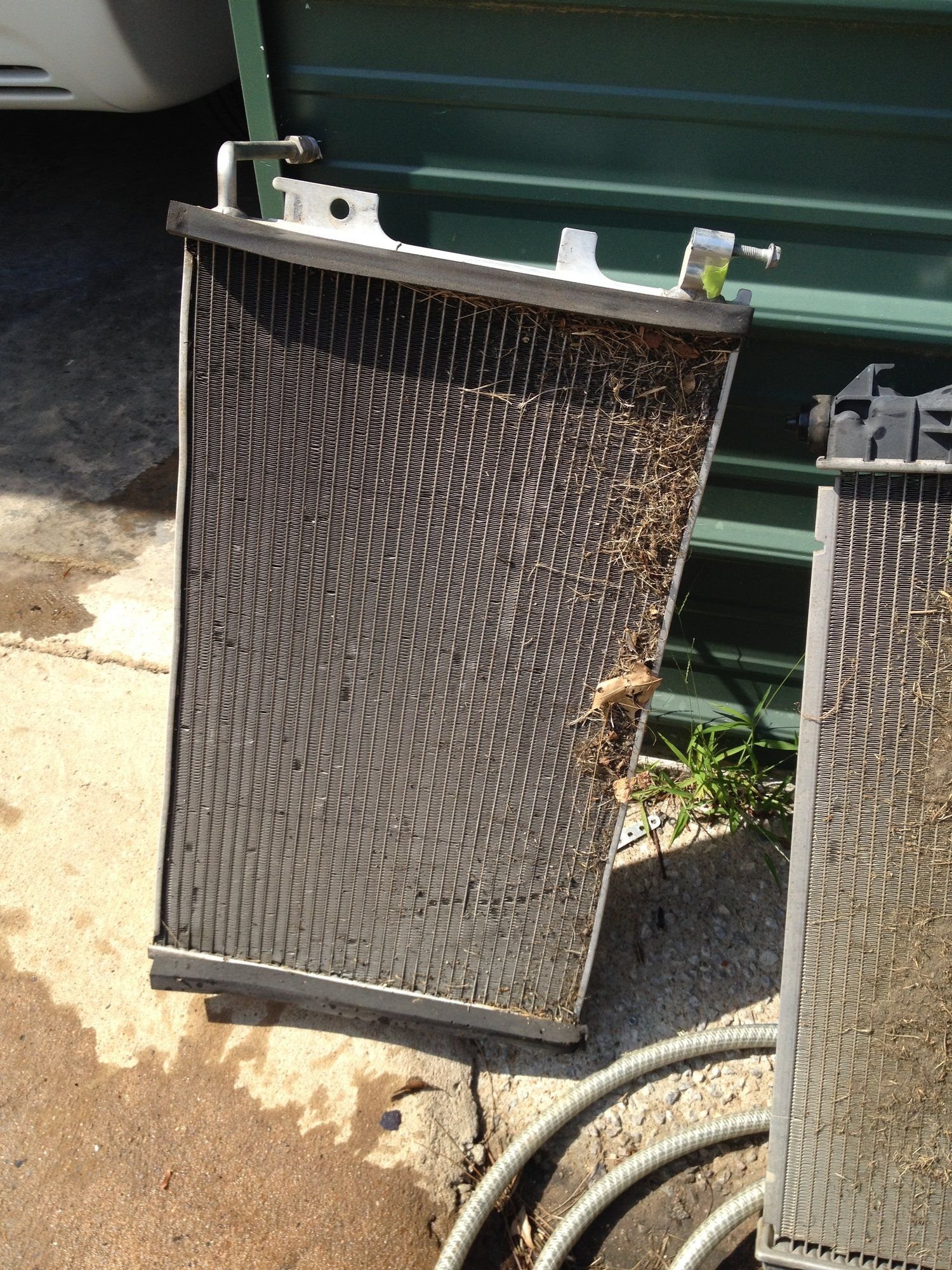

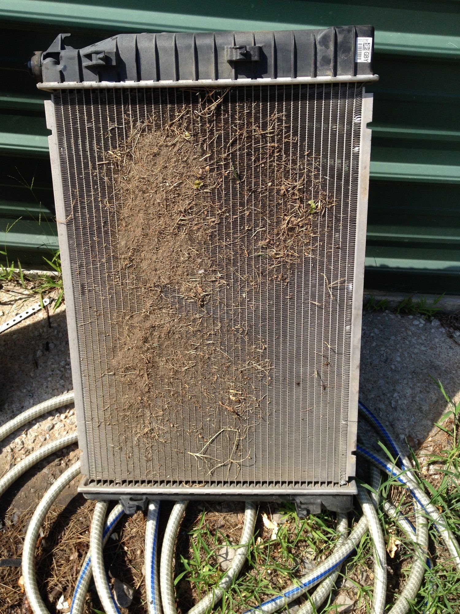

Originally Posted by jim2527
As a reference point, my C5 would over heat Miami stop n go traffic. If would go into 'limp home' mode. Only way to keep it cool was to crack the hood and turn the heater on.
I have a C5 as well. C5s have a very different cooling set-up.. known overheating issues.. But C5s run hotter anyway, High fans does not even engage til 238* ...and they are bottom feeders, .I ll bet that if you remove the top mounting panel on your C5 radiator and look between the Radiator and A/C condenser, you will see 1/4 to 1/3 of your radiator covered up in leaves, plastic bags, bird winds and other debris.. Its not enough to clean the front of Condenser , you must clean out BETWEEN the two.. and turning A/C on high engages fans at a stop..
Old Aug 12, 2019 | 08:41 AM
GUSTO14's Avatar
GUSTO14
Joined: Sep 2003
Posts: 8,812
Likes: 2,029
From: eastern NC
Jim, Fishslayer is correct. If you remove the top panel you may well find your C5 radiator partially blocked with an abundance of plant debris and even trash that accumulates there over time. It's prudent to check this out periodically to ensure you are getting the most cooling possible from your radiator and condenser. Because the area between the radiator and condenser is so confining, it can be difficult to see just how much debris is there and add to the difficulty in removing it. Use care to not damage the fins of the radiator and the condenser.
Here are a couple of pictures of what other members have found when clearing the debris from that area at the front of the car.
It shouldn't be necessary to remove them from the car to clear them out unless they are packed with debris and have never been cleared before. Be careful about applying too high a pressure of air or water to the radiator/condenser as it can result in damage to the fins of an older unit.
Good luck... GUSTO
