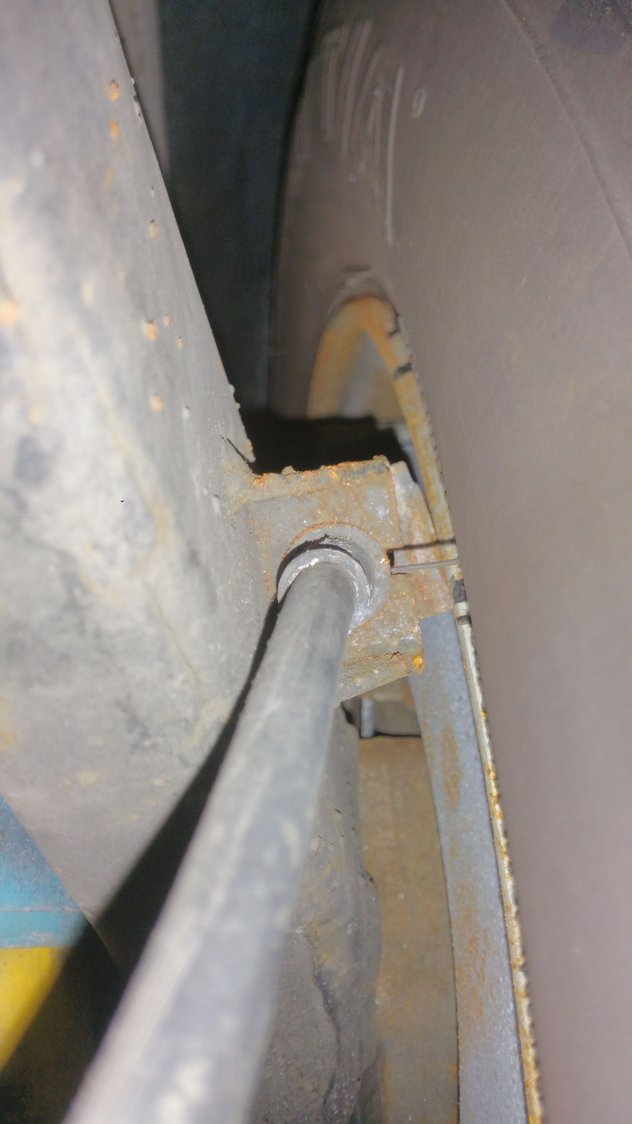

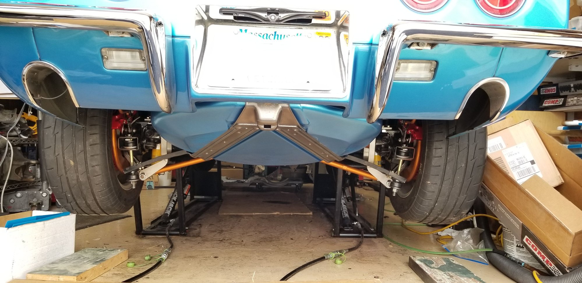

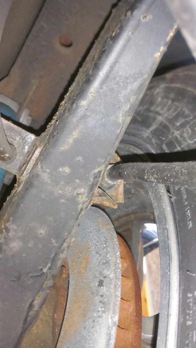

Yes 15x7 are stock, 15x8 look cooler. 17x 8 give you the best tire selection. You want to go to a supplier that actually lists the back spacing for a 68. The rim of a 15 inch wheel will be withing millimeters of rubbing the parking brake cable boss. Be aware of the spring to rubber distance too. This was the monospring I used to run on the car
these are a 15 inch factory wheel.

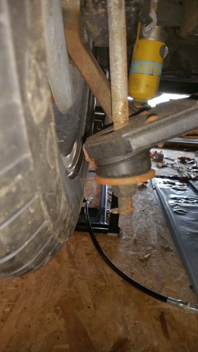

I currently have 17x8 American Racing Torque Thrust II with Firestone Firehawk 235/55/17 tires which is almost the same meassurement as the stock 27.2 inch diameter. Plenty of rear room, I had a slight rub on the front at full lock on the frame with the factory front A arms. Im running a full VBP system now
17 inch clearance
the red stripe is a Rimsaver from RimbladesUSA
current setup still plenty of room
