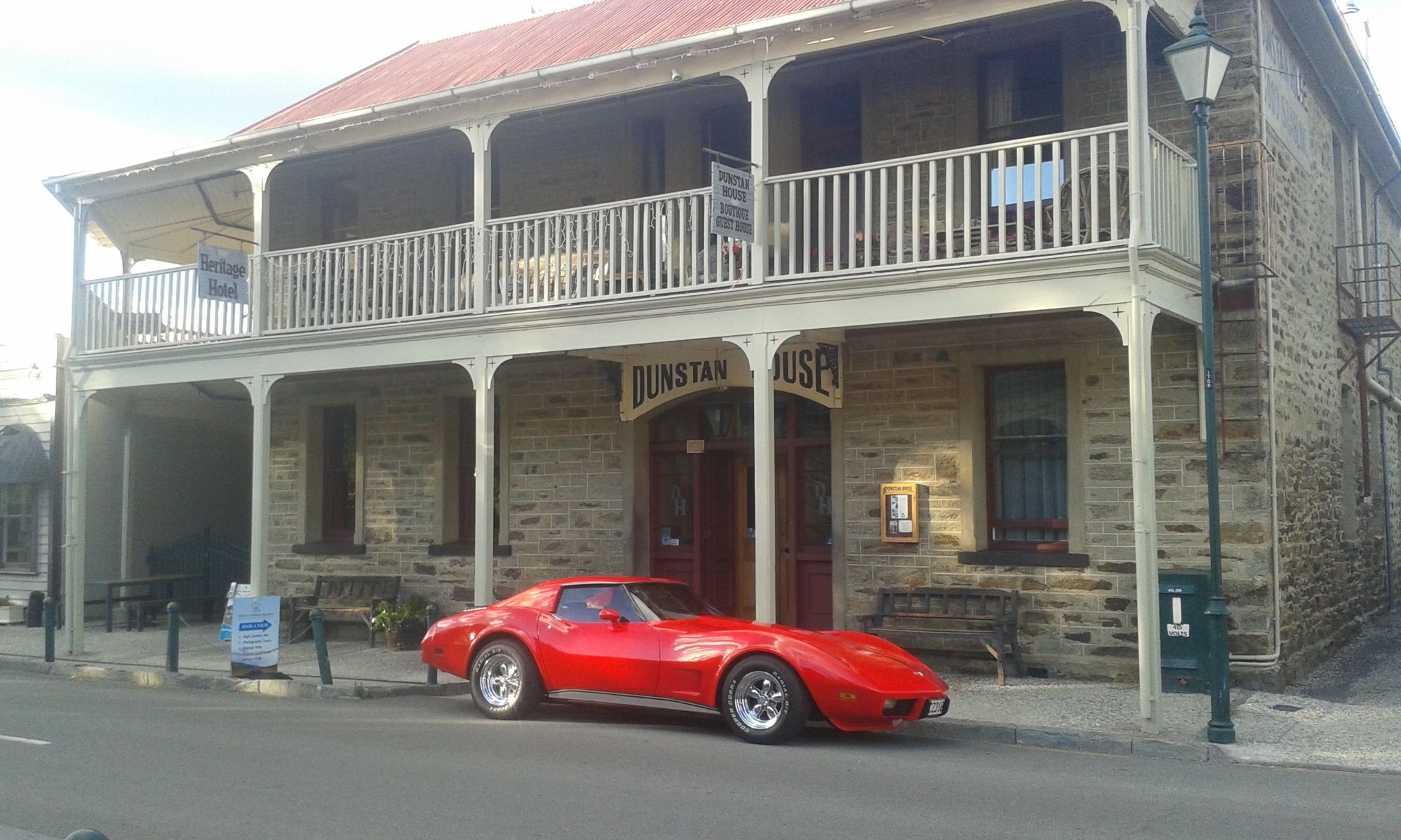

I think 10" will be away to long...I got 10" C4 bolts and cut them down to 8 1/2" drilled the ends and used castle nuts and split pins....sorta make them look stock!
When you have a full tank and two people in ....it sits looow

My height changed 1 3/4" going from 6 1/2" std bolt length to 8 1/2",also I didn't trust nylon lock nuts.. that was the other reason I went with castle nuts
