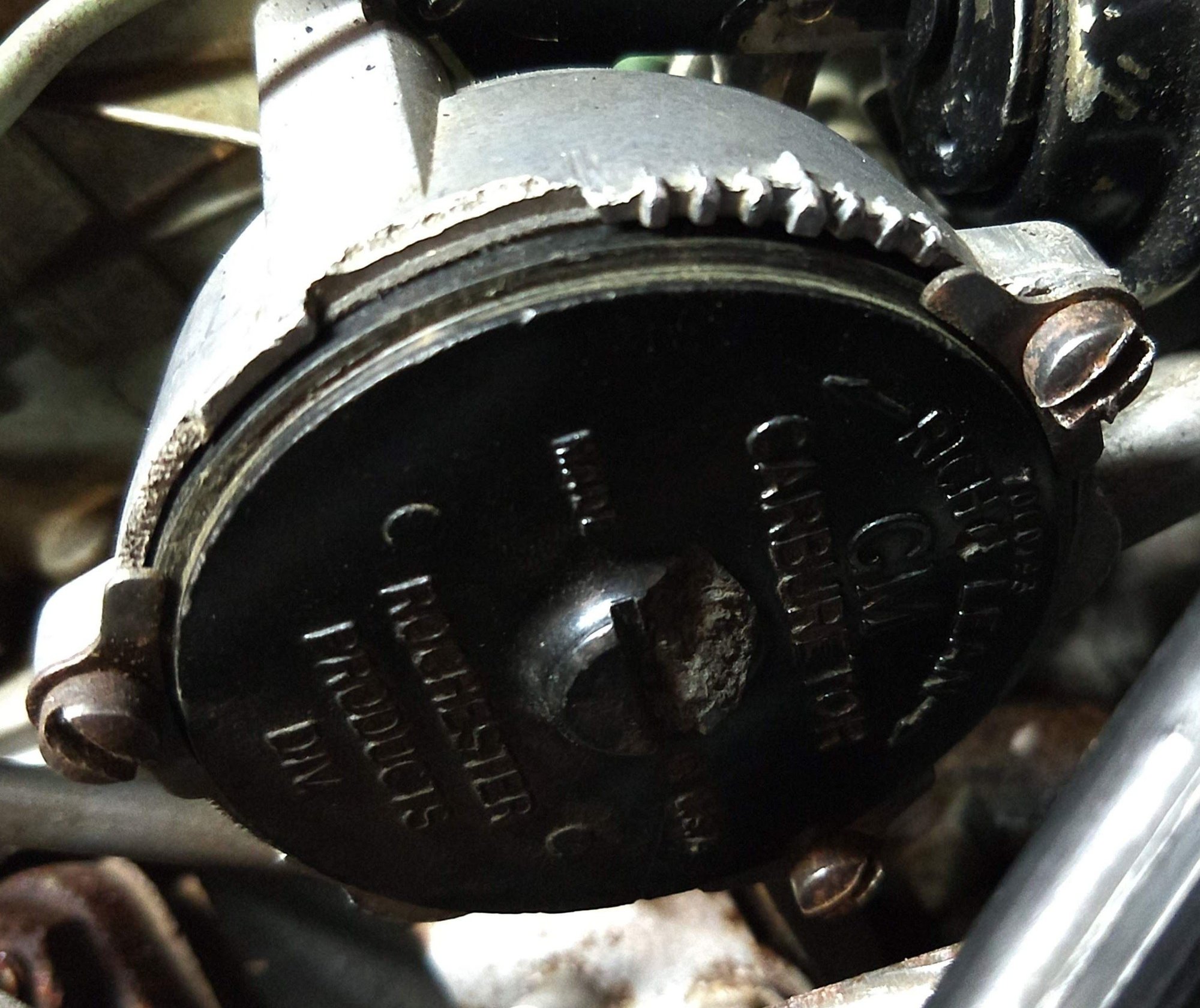

Turns out everything was set up properly except the choke thermostat / coil spring. After pulling it off and ensuring nothing was broken, I reassembled it and set the tension so that it would just close the choke plate when the carb was in the fast idle mode... however it was taking it 10 minutes to drop into the slower idle mode when I drove! Thankfully from Lars's write up I learned about the nonsensical "rich/lean" markings on the choke housing... why was that ever done? After loosening the screws and rotating clockwise, the time to open dropped to just over 3 minutes. Question... should I rotate a little more clockwise to get the time down to 2 minutes? or what is the ideal time? this morning it was 3 min 30 seconds to kick down with the hood open and the ambient outside temperature / cold engine temperature of 45 F.
Also... the markings on the housing aren't even close what would seem reasonable... anyone understand this... maybe the spring just isn't warming up as fast as it should? The choke is closing just fine so it seems like its starting with plenty of tension. Here's a picture:

Disregard the markings. Set the choke to provide reliable idle quality during the warm-up intermediate period. Some cars need 2-3 minutes, and others need as much as 6. As long as it's neither dying nor flooding, and if idle speed in the "partially warm" mode is acceptable, you're good to go.
