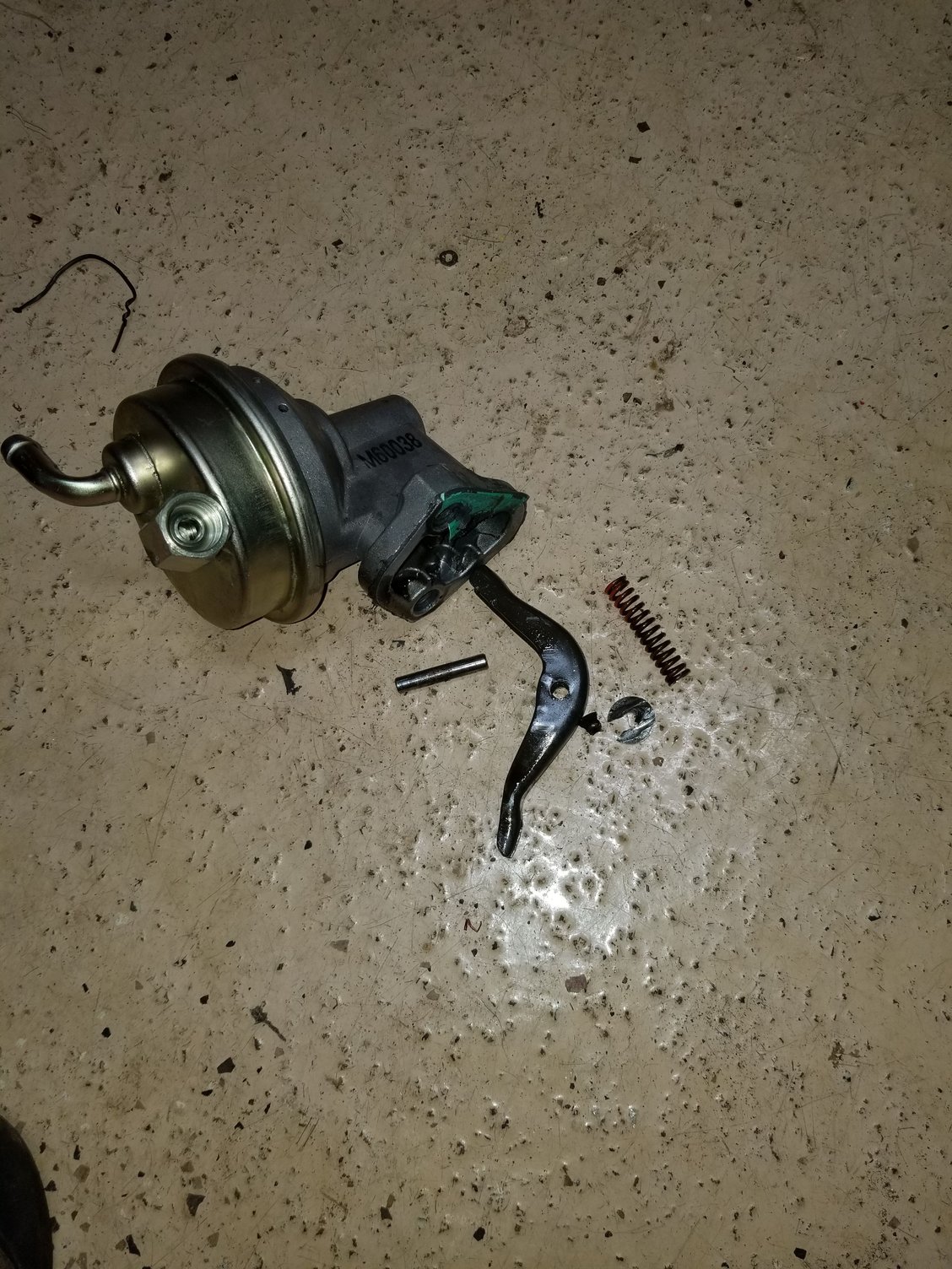

Nope. The stock pumps from Carter are garbage, I've been through 3 different replacement ones. My edelbrock pivot pin is pressed into a hole. The carters are swaged in from the side. I wont run a stock pump again.
