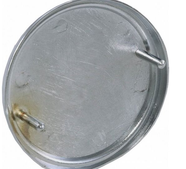

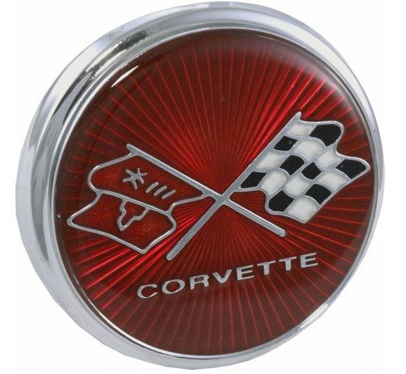

Are you sure that the emblem that measures 2-1/6" C-C is a front emblem and not a fuel tank emblem? My '71 front emblem measures 3-1/4" C-C and I installed a newer '73 to '76 front emblem on my '71 around 1976 because I liked the style. It was a perfect fit.
I have since replaced it with the original '71 front emblem.
73-74 Front Emblem-Front view
73-74 Front Emblem-Rear view
75-76 Front Emblem-Front view
75-76 Front Emblem-Rear view
