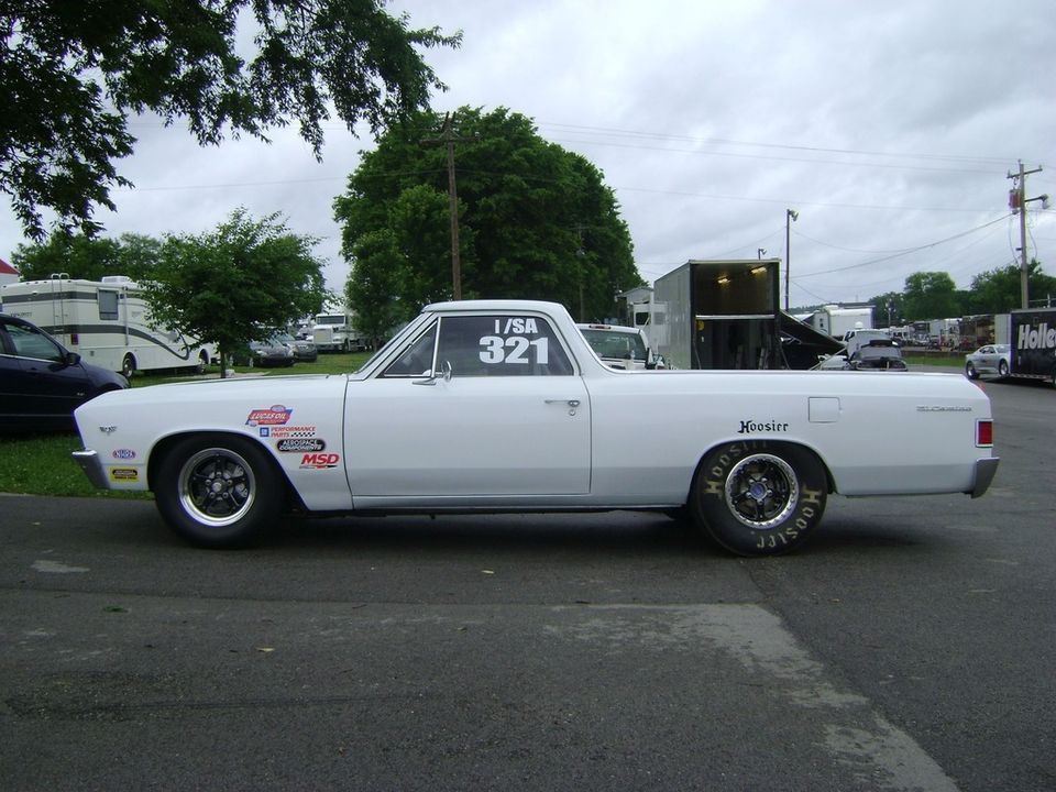

This '67 flat tappet machine disproves your assumption about modern synthetic oils better than any words...take that to business class.
Appears you are in need of reading material... https://540ratblog.wordpress.com/201...-test-ranking/

If you knew even half of what you think you do the vehicle image would be self explanatory.

Exactly what I surmised...you have no clue. First hint...NHRA Stock Eliminator. Don't bother with the racing banter...easy to see you have less grasp on the subject than even oil.

As are you...just trying to figure out the thought process on oil choices. The 327 depicted above backs up my views.

Yet this guy runs the most modern synthetic oil in his flat tappet engines...who is it here that can't get out of the 70's? This is what happens you gulp down the marketing ploys instead of relying on science. I have already linked above about the additive ZDDP. More ppm of ZDDP in oil does not equate to greater protection...that is not how ZDDP works at all. More ppm only means it takes a longer period of time before it is depleted.
