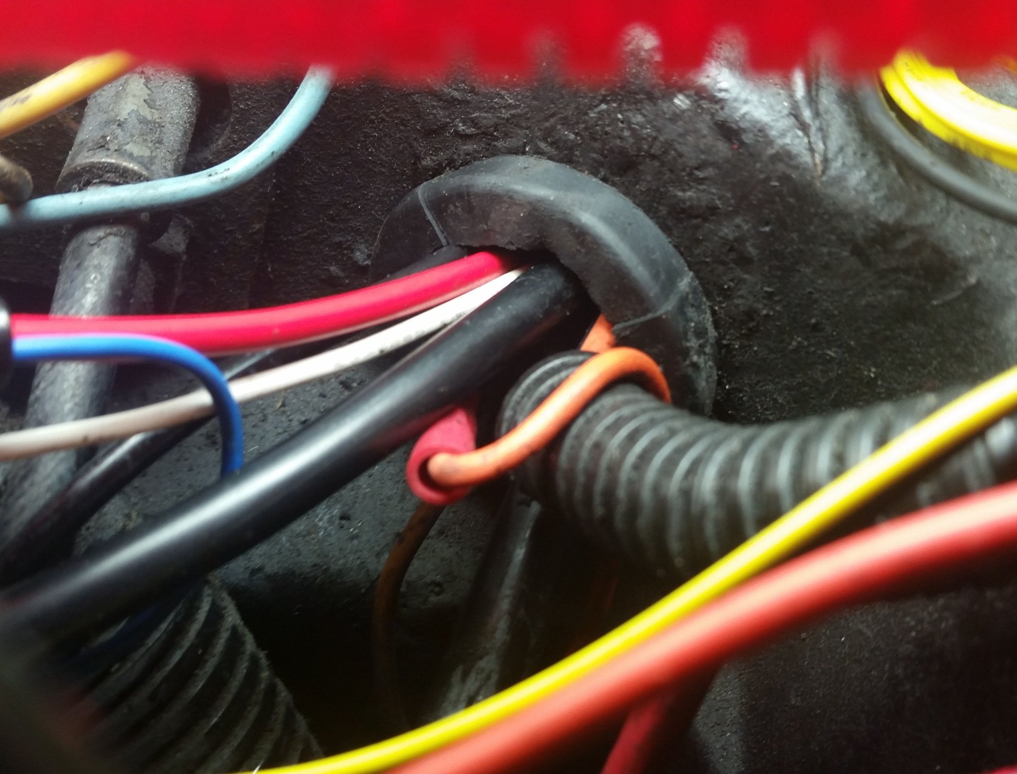

I routed mine (600 power adder), with the battery feeds etc, through the speedo cable grommet - I run a GPS speedo now so no longer have a cable there, but I did when I installed it. I also extended my controller leads so that I could run them into the glove box, that was a bit of work though.

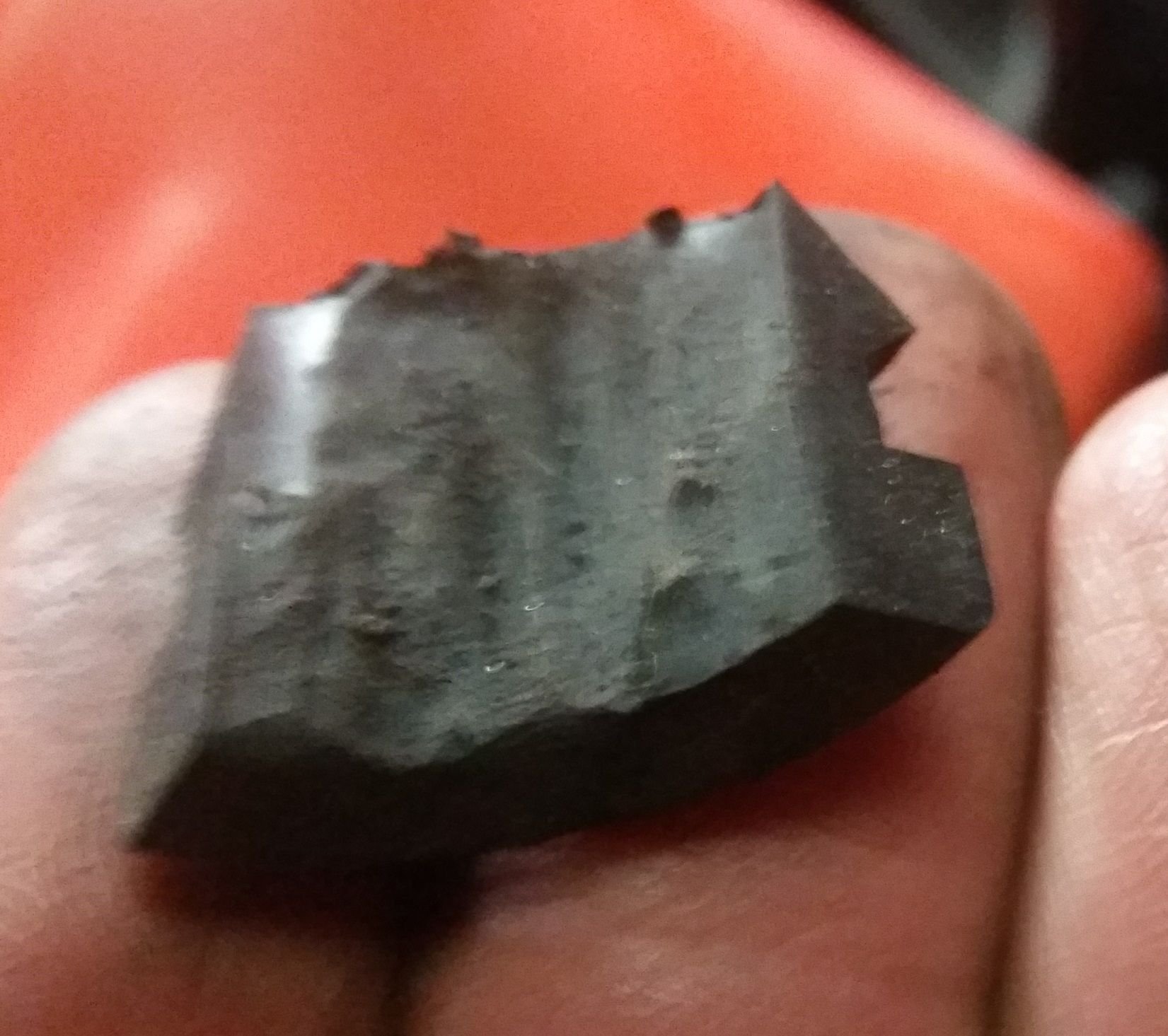

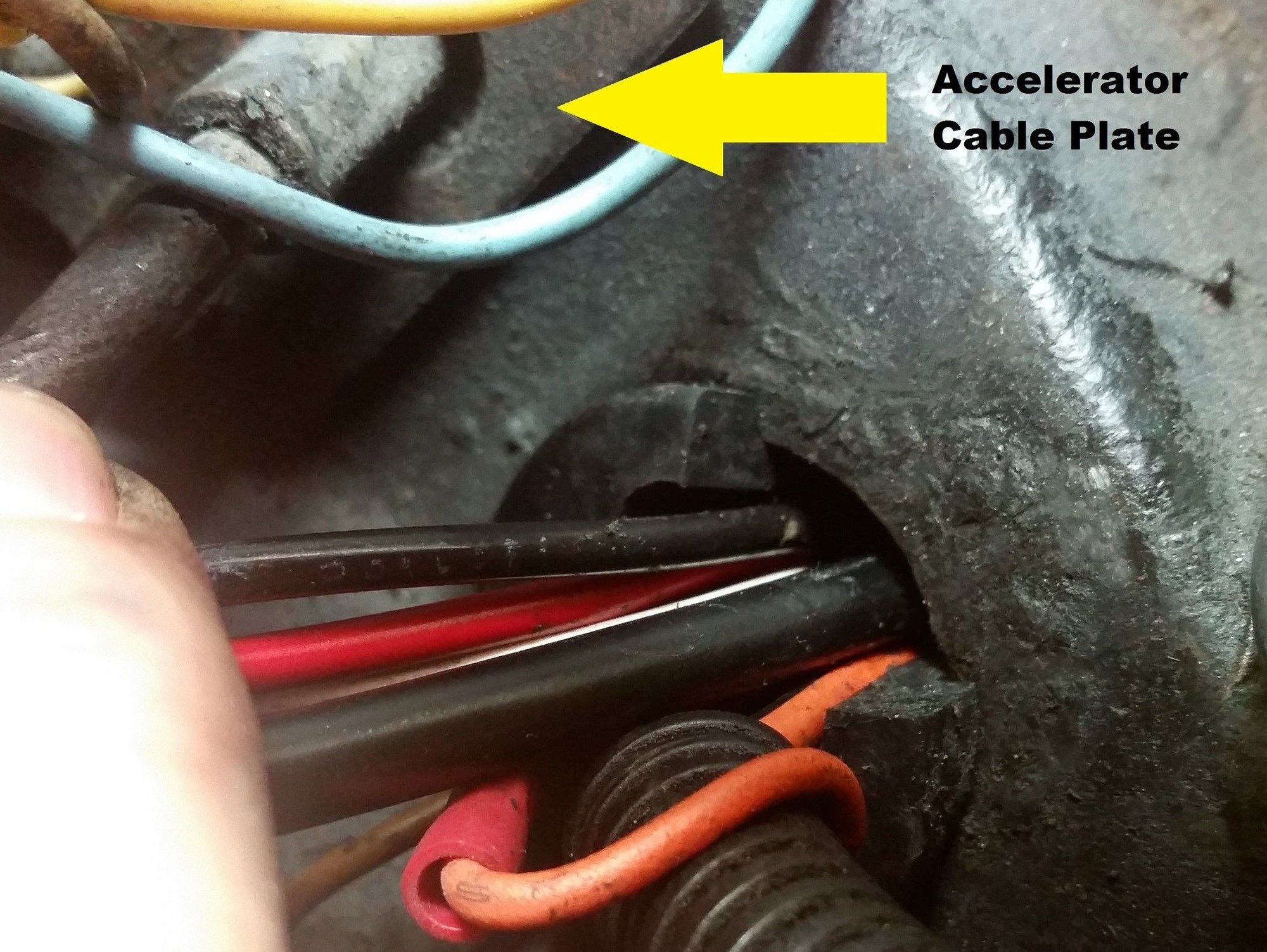

Used the existing stock grommet. Couldn't use the accelerator because it's a plate, on my '73 anyway.
Cut the interior out a little.
About as good as it's gonna get. Well maybe a dab of black RTV.
