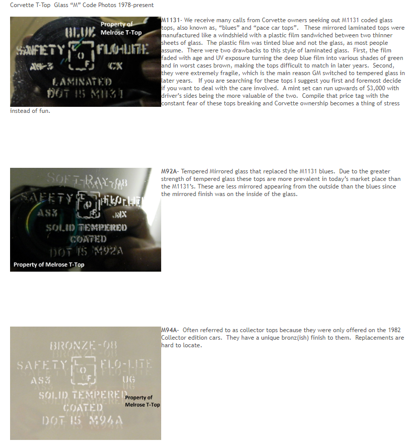

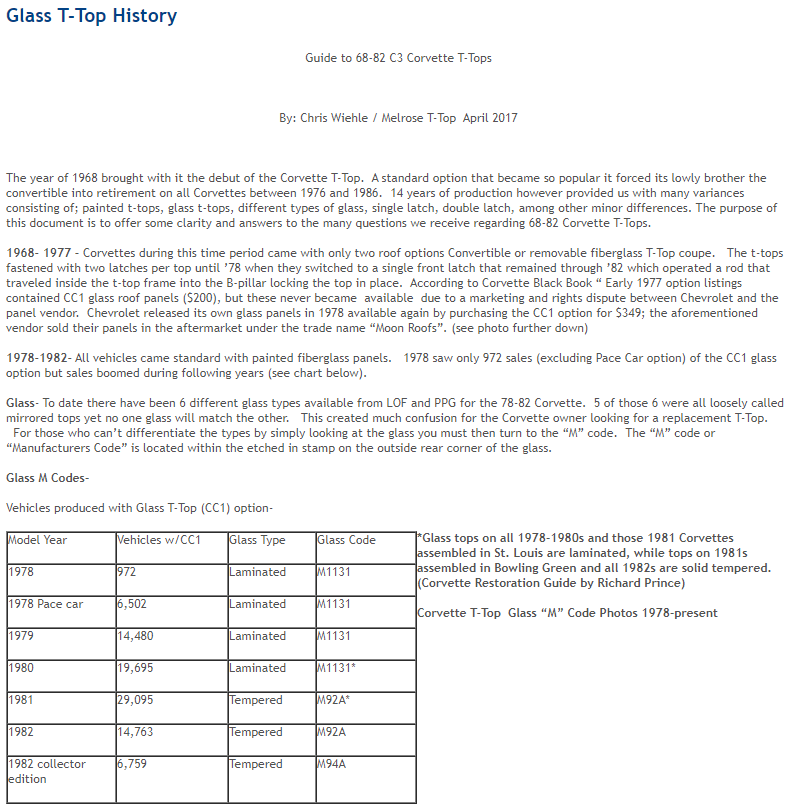

As a result, I did some further searching and found this:
Looks like I'm looking for the M1131 T Tops - and of course the Drivers side (which is what I need) is the most expensive
