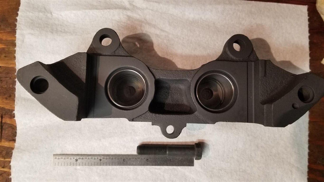

On the rear you want the shoulder because of casting of the housing, you could use full thread on both F&R.
Working on a extra set myself. Bolt shown is for the housing half's.
