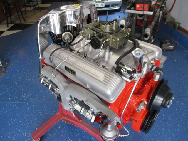

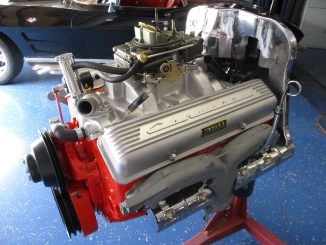

Likes: 6,371
The L79 '65 factory setup looks like this. It used rubber hose from the filter to the carb inlet, which is on the driver's side of the correct L79 carb. '68 is similar, and retains the driver's side single inlet carb:
Lars

The problem is the banjo fitting carb inlet on the L79 Holley carbs. It's the reason GM used a piece of rubber line from the filter to the carb.
Lars
