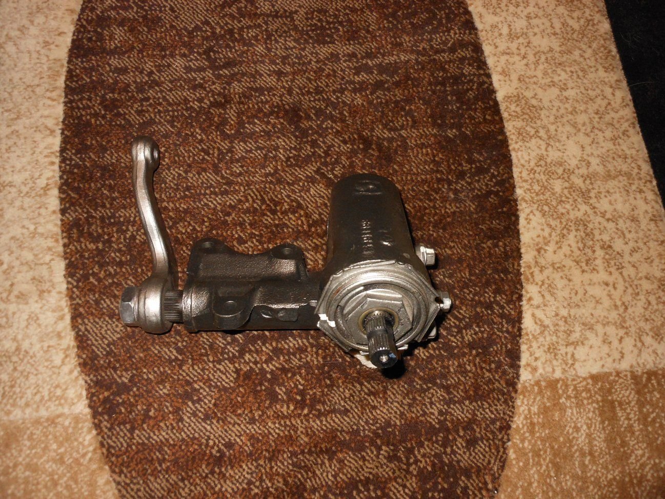

Or you can buy mine-
I had it rebuilt many years ago but never used- ended up going with electric power steering.
Vansteel rebuilt my original box off my 71- a rust free Georgia car I have owned since 1981.
It's yours for $200 plus shipping.
Just shoot me an email- Richard454 at comcast dot net
