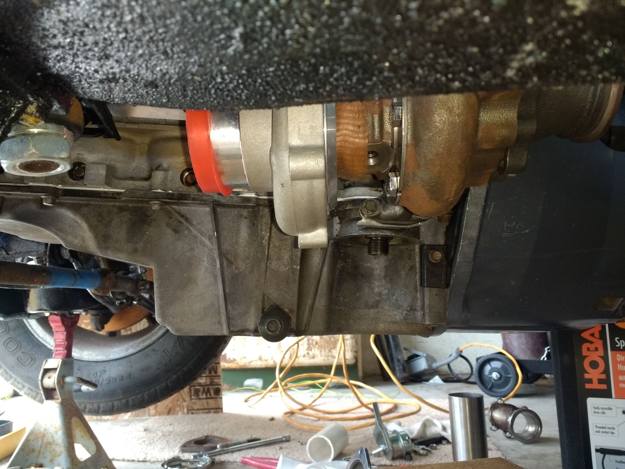

Thought I would post some pics for reference. Running a Silverado manifold on the left side, made my own adapter. Looked at putting it high behind the wheel, but too much tube and bracing from the engine.

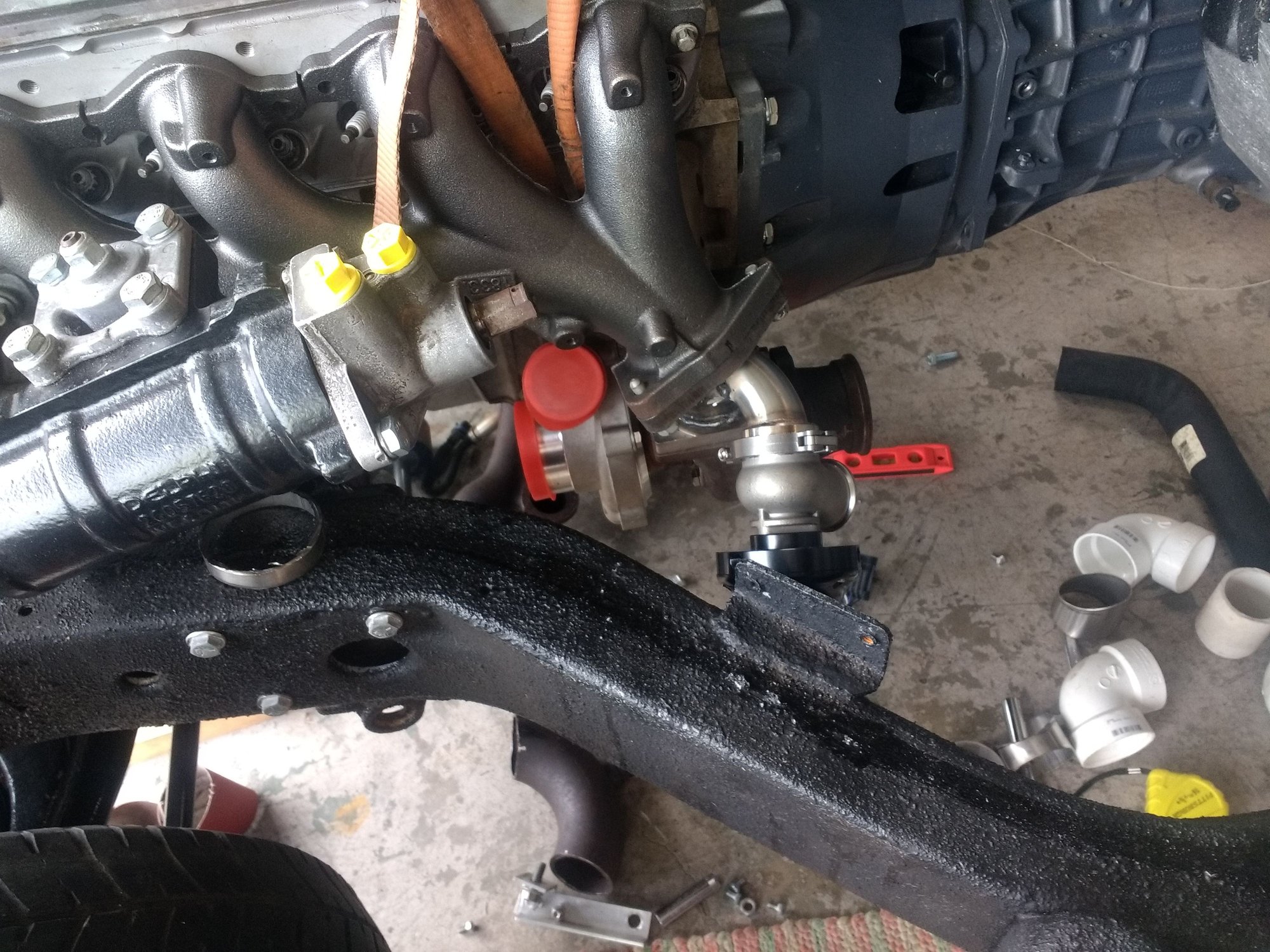

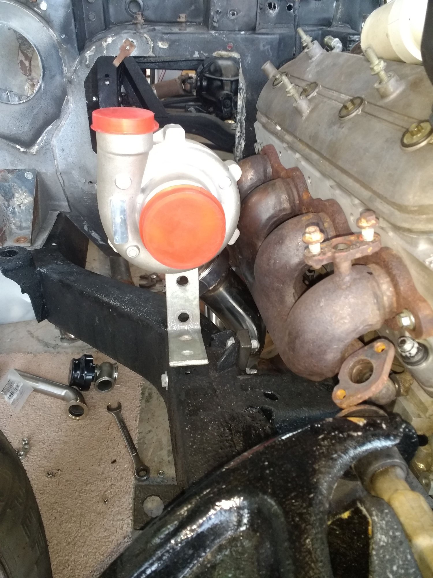

Here's the right side, waste gate is not installed yet. Using an F-body double wall steel manifold.
The L bracket is just there to hold it up. Will require bracing from the engine.

get your tube of Vaseline and shoehorn out. C3 is a tight platform. Been there.
You'll need a scavenge pump for the lower turbo.
Looking forward to progress.

Turbos were hanging too low, so I cut the flange off the truck manifold on the left side. Welded a T25 flange on, which raises it significantly, and puts it above the oil level in the pan.

I like that alot better.
I'm confused. I see an external wastegate in one photo and an internal in another. what's the story?

The turbo has an internal waste gate, was planning using externals.
I'm debating whether to drill a hole in the manifold and weld in a sched 40 pipe for an external, or just run it with the internal and see what the pressure inside the manifold is and if I get boost creep.
