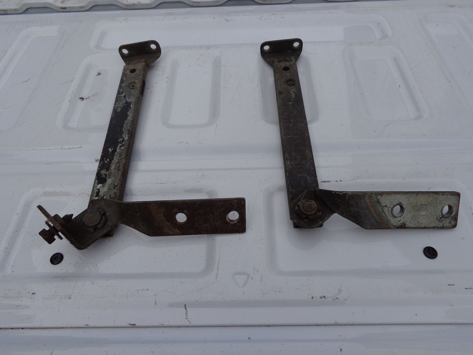

Here are the 2 types

Thanks everyone. This is the exact information I was looking for. It looks like the ‘69-‘71 is actually the best option because the 3 bolt mount looks the same as the one on my ‘72. And costs less, which is always a bonus.
