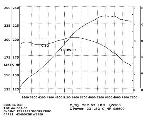

I had a '77 Ferrari 308 for a while.
3.0 liter V-8, flat plane crank, 4 downdraft Webers. 255 HP. Not bad for 2 valves and 8.8:1 compression. Idled at 1000 rpm, pulled to 7700 rpm and sounded awesome. Very flat torque curve.
Dyno for stock 308GT4 engine (very similar):
Here is a shop that offers flat plane LS and SBCs.
