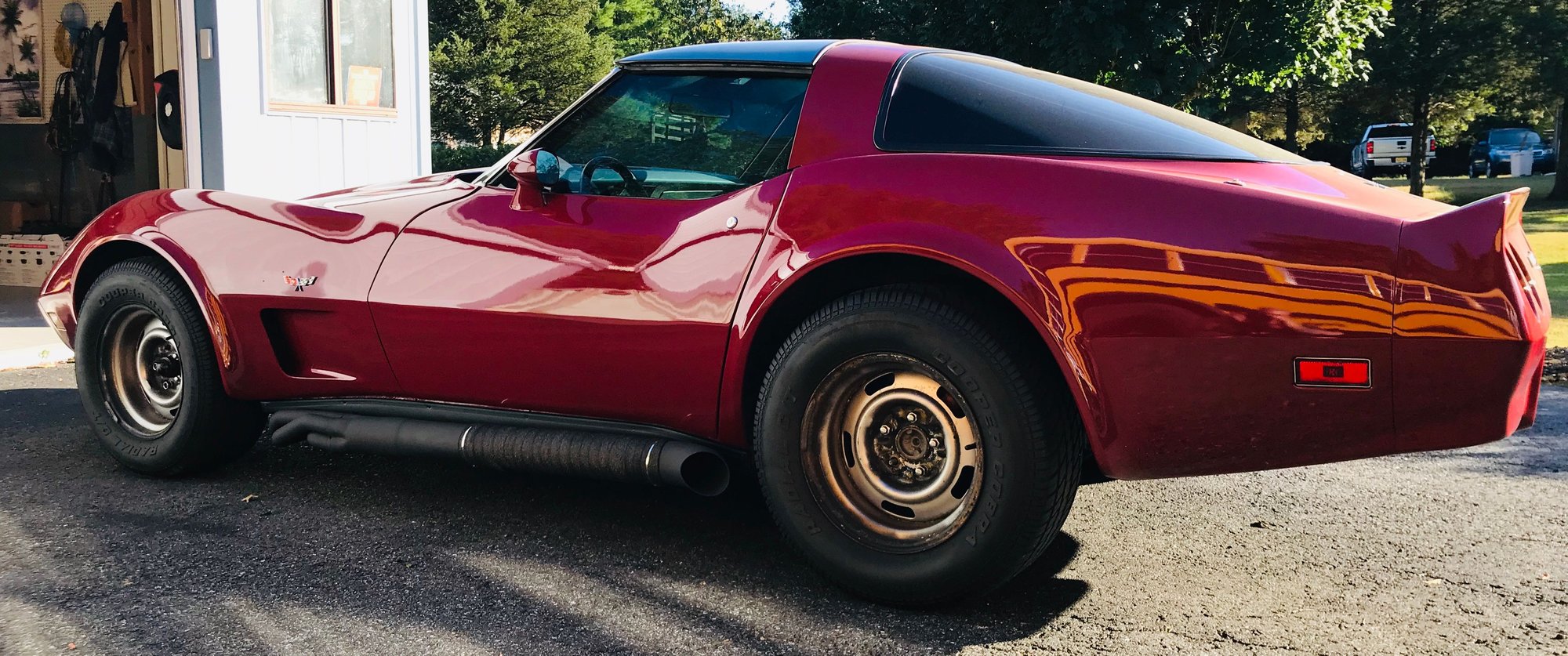

So I am looking to lower the rear end on my basically stock 1979 Vet. I have search many posts on here and can't seem to find the right answer. So old threads mention VDP bolts that are 10" but google search comes up with nothing. I really only need the bolts as the bushings are new. Most places I search for lowering bolts only come up with 8". Why can't I find any 10" bolts to lower the car? I know there are pros and cons but what is the basic difference if I use and 8" or 10" bolt. Looking to go maybe 2" lower to clean up the look in the rear. No I don't want to change to a larger tire. Just want to drop the rear a bit.Some other threads mention you can get Grade 8 bolts at Fastenal. Help! Too many threads that get confusing. I just want a simple option for my weekend cruiser.

Most Corvette parts suppliers carry them.
It looks like the front could come down a bit too,

Yes I am gonna get to the front once I figure the rear. Problem I am running into w Vet suppliers is that they only carry 8" bolts. I don't think that is gonna give me what I am looking for. A lot of older threads mention 10" bolts but they are no where to be found as a kit for the C3,

Thanks! What did u do to drop the front. Looks nice!

460 lb. coil springs with 3/4 cut off.
