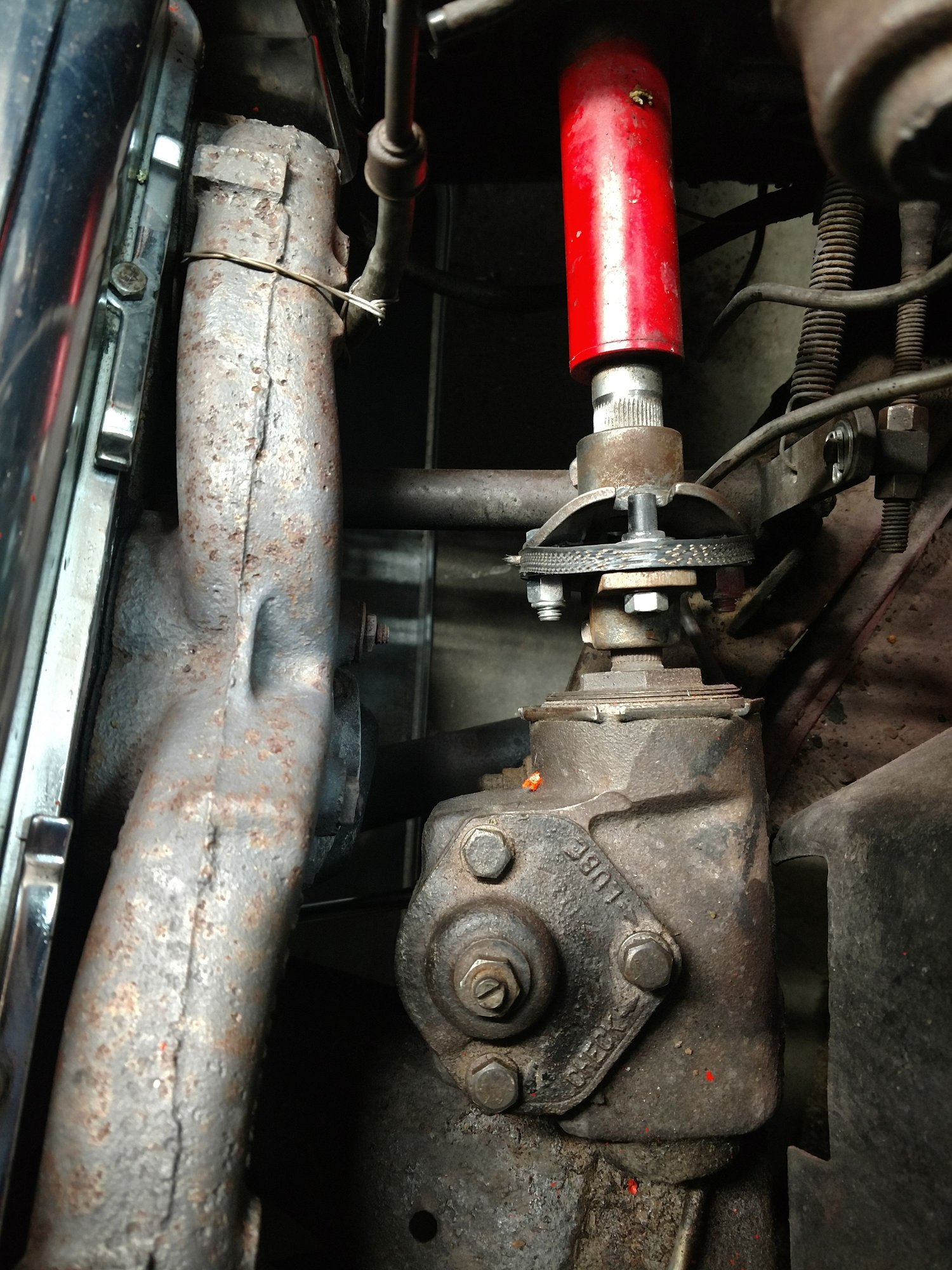

The point with the IDIDIT column is that you can NOT hammer on the end of the column to adjust the length, to fit a new steering box. You can cut it to fit as I did. The easiest way is to get a DD rag joint end, then use a cutting wheel to shape a new DD end on the cut column shaft. It needs to be a 1 inch shaft.
This is before.
This is after.
This is how to make a mock column to figure out how much to cut off. As you need to remove the column when you install the new steering box
