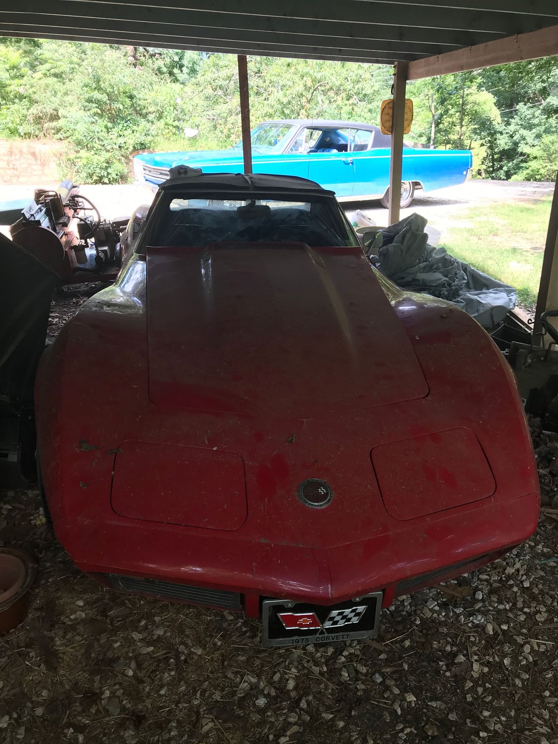

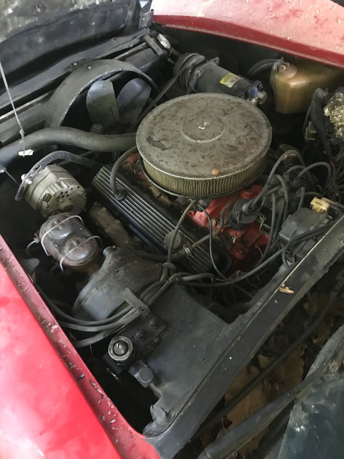

Hi. My first post with questions about a 1973 L82 Stingray.
my wife inherited this car and wants to sell it pronto to pay off some bills. My father in law was second owner and drove it infrequently. He parked it under a shed in 2005, put a car cover on it and never did anything with it after that. He purchased it in late 80s.
I am tasked with getting this car running. I have my own 68 Plymouth to work so I want to get done ASAP. Wife can’t seem to sell it “as is”.
i have turned engine by hand then with starter. Oil and coolant look good. He ran the fuel out and so far only the fuel pump is shot, which I am changing today. I have blown out the lines. I am leaving the carb alone until I see how it does.
i have looked at ignition. Points look new. Distributor cap had corrosion, so I have replaced it. Never got 12 volts in Start. I found the wire on the starter to the coil is missing. I should be able to trace it. In ON I have zero volts. Shouldn’t I have 9 volts or so?
I can see the flywheel teeth. Shouldn’t there be a cover?

Doesn’t look too bad for sitting that long.
Yes there should be a cover for the flex plate or flywheel, but it is often removed and put away somewhere. If you’re selling it, I wouldn’t worry about it.
You should have a full 12+ Volts at the coil when the ignition is in the start position. A little less in run (don’t recall the number, maybe 10V?).

Originally Posted by CA-Legal-Vette
If you get it running, makes sure the brakes are working before taking it for a spin. The brakes on these cars REALLY don’t like to sit.
The rears are stuck. Going to tap lightly on the drums. The front discs are not stuck but the rubber hoses could stand to be replaced.
Four wheel disc brakes, but there sort of are drums in the rear. The parking brake is inside drums built into the rear rotors. Not uncommon for them to seize.
