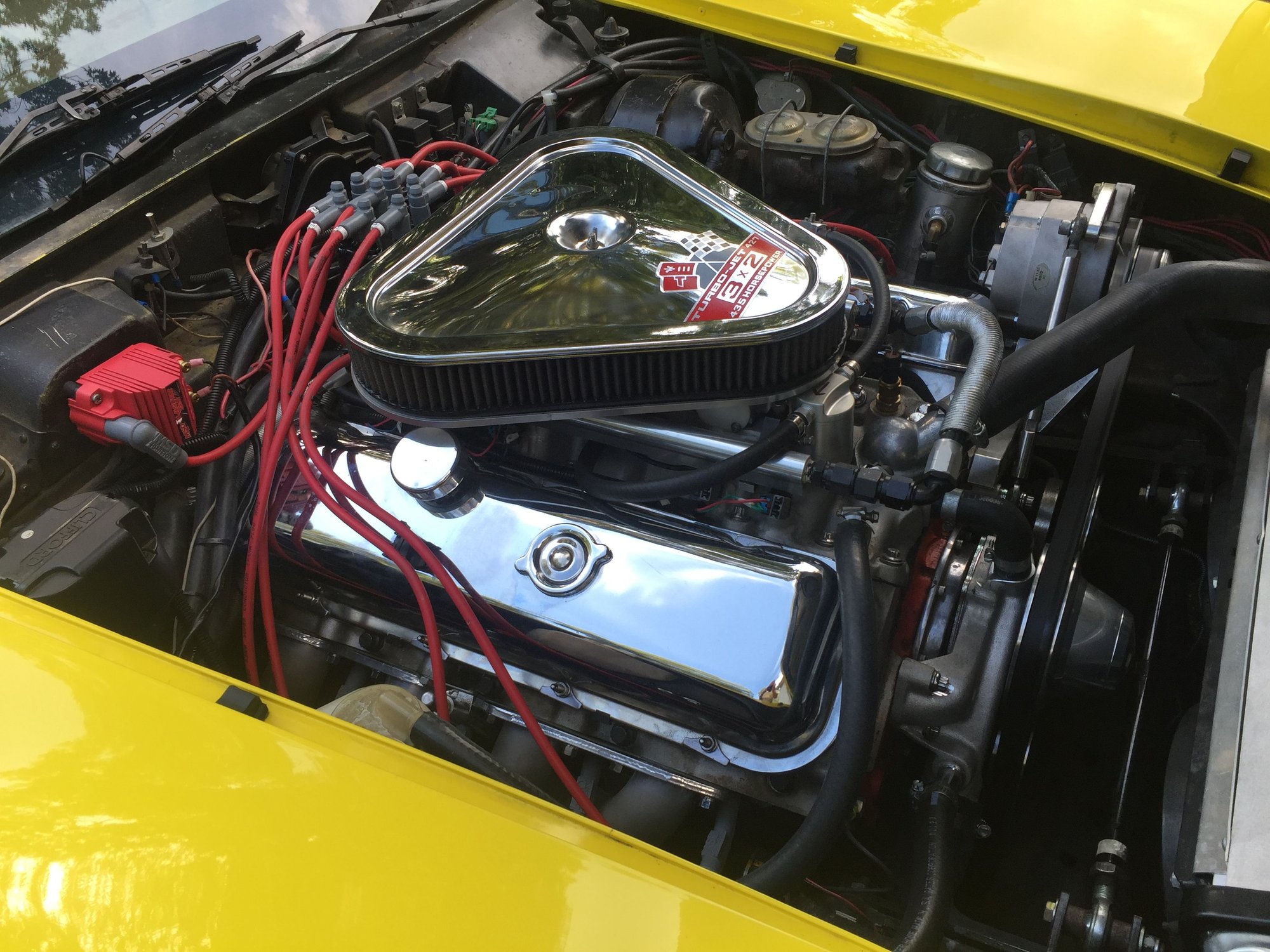

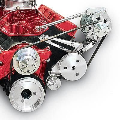

I have a March setup and it works great. I have the type II PS pump. I prefer the type II since I don't have to move/remove the alternator to check the PS fluid (you can see my reservoir in front of master cylinder).
I am also running the Edelbrock 8852 water pump. Standard rotation, short pump. The March setup uses a standard rotation pump for non-A/C and reverse rotation for A/C. Not sure what GM delivered with the 427 crate.
https://marchperformance.com/chevy/c...nt-deluxe.html
Not the best pic, but you get the idea. Just make sure you get high flow pulley setup (smaller crank pulley to increase water pump speed).
March pic:
