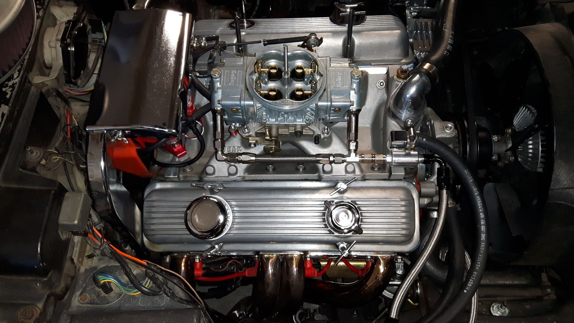

Old Oct 18, 2019 | 10:41 AM
resdoggie's Avatar
resdoggie
Had a 1976 L-82, 4-sp
Joined: Mar 2011
Posts: 5,338
Likes: 1,213
Royal Canadian Navy
Originally Posted by Jebbysan
I like all of the Air Gap stuff though because you can hide lines, wires, hose underneath it.
Like this?
For the uninformed, the Team G is an air gap intake.
