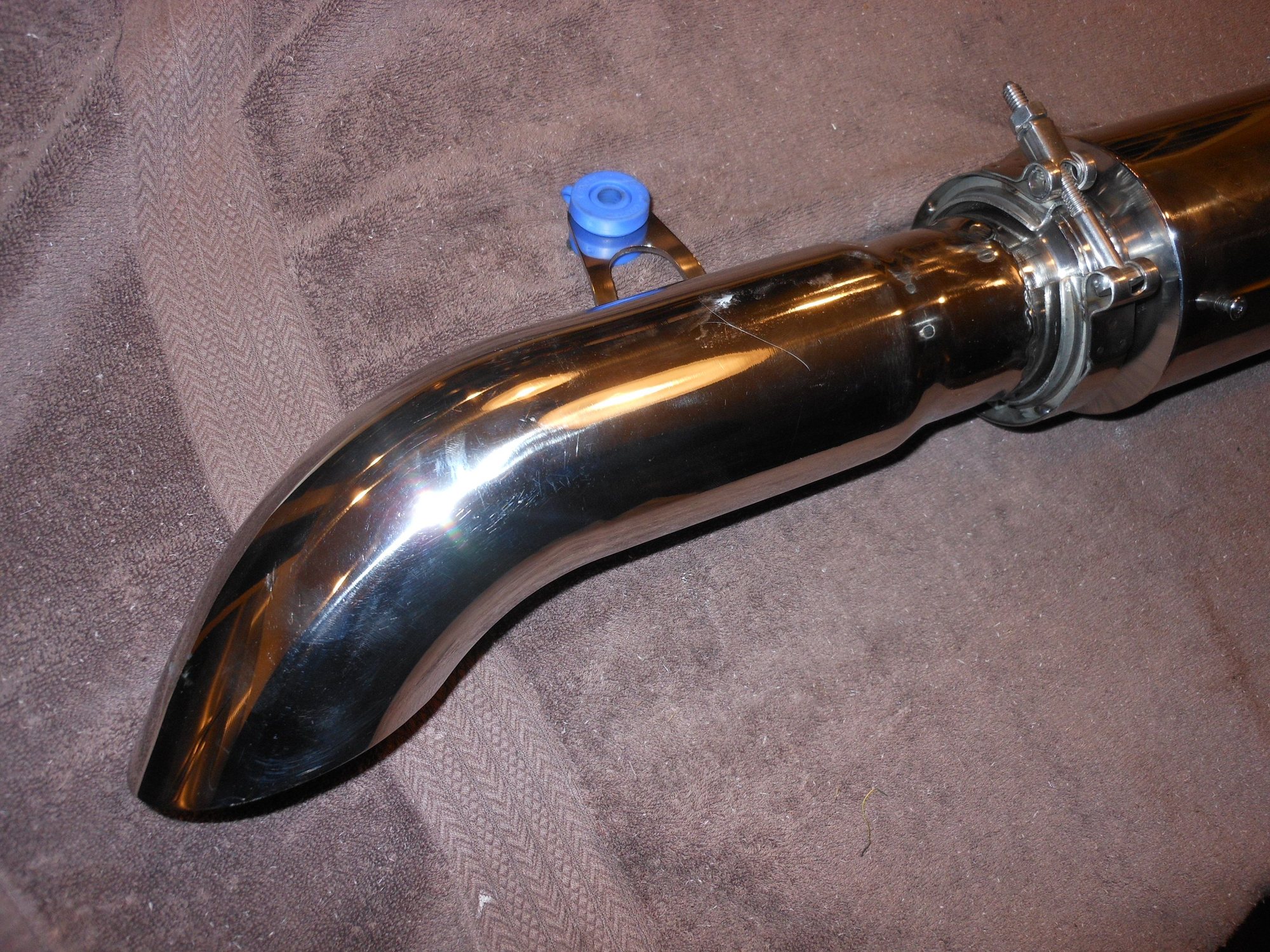

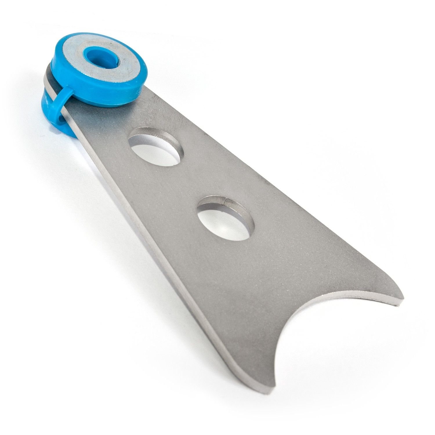

When I made my sidepipes I used Stain Steel Works hangers-

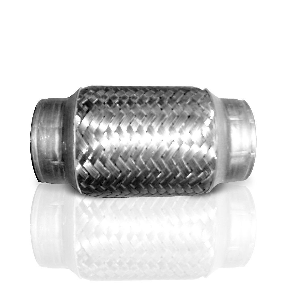

Another option would be a flex pipe-
