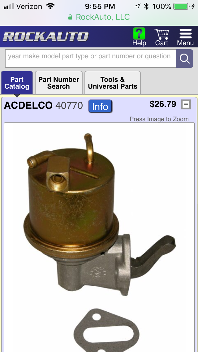

Hi guys, I bought a nice Holley before I realized there is a return line and Holley doesn’t make a mechanical with a return line. What are you guys using on your BBC in a 76 C3?

Old Oct 18, 2019 | 10:54 PM
speedreed8's Avatar
speedreed8
Joined: Oct 2006
Posts: 2,417
Likes: 336
From: Texas
AC Delco. #6470309.
