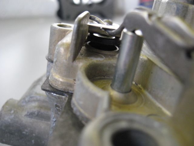

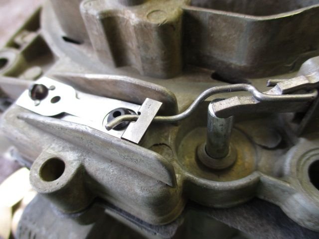

1966 - early '70 Idle vent:
Correctly adjusted at idle, with the vent cracked open. Adjust by bending the wire:
It's more likely that you have slight seepage past your needle/seat. At running rpm, this seepage is irrelevant. But at low-fuel demand conditions (such as idle), the seepage can exceed the fuel usage of the engine, resulting in a gradual "creep" in fuel level in the bowl, until flooding starts to occur. I would pull the needle out of the seat, blow the seat out real well, clean the needle, and then check/re-set the float level to .300".

The idle vent valve was used from 1966 through early '70. Your '72 does not have an idle vent valve, and just vents the bowl through the normal bowl vent tube.
It's more likely that you have slight seepage past your needle/seat. At running rpm, this seepage is irrelevant. But at low-fuel demand conditions (such as idle), the seepage can exceed the fuel usage of the engine, resulting in a gradual "creep" in fuel level in the bowl, until flooding starts to occur. I would pull the needle out of the seat, blow the seat out real well, clean the needle, and the check/re-set the float level to .300".
