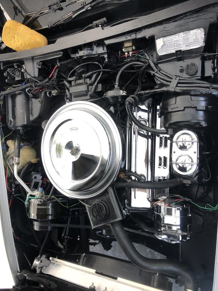

Originally Posted by wilcar
If your 82 has the L82 style aluminum valve covers what don't you like about them? I have them on my 84 C4 and had them sand blasted and then had them powder coated in an aluminum finish. I started to sand them down thinking they were aluminum.......wrong, they are magnesium and will turn a dark color if left bare!!
I like mine. My alternator sits close to the valve cover
To valve covers
