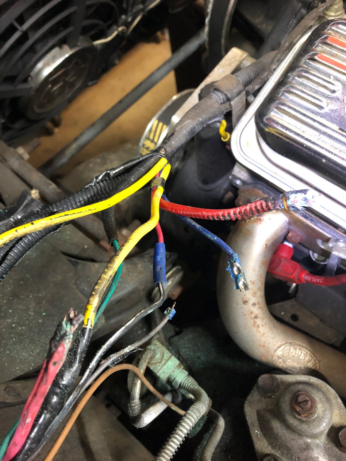

Well well well. Hope this is the whole problem

Check the complete wire end to end to make sure there are not any other burnt areas. Make sure your repairs are sealed.

Will do. There was a splice right there and a weak spot. Also there was some smoke from the upper dash area. I guess I’ll try to find a wiring diagram for a 72 I have one for a 75.
