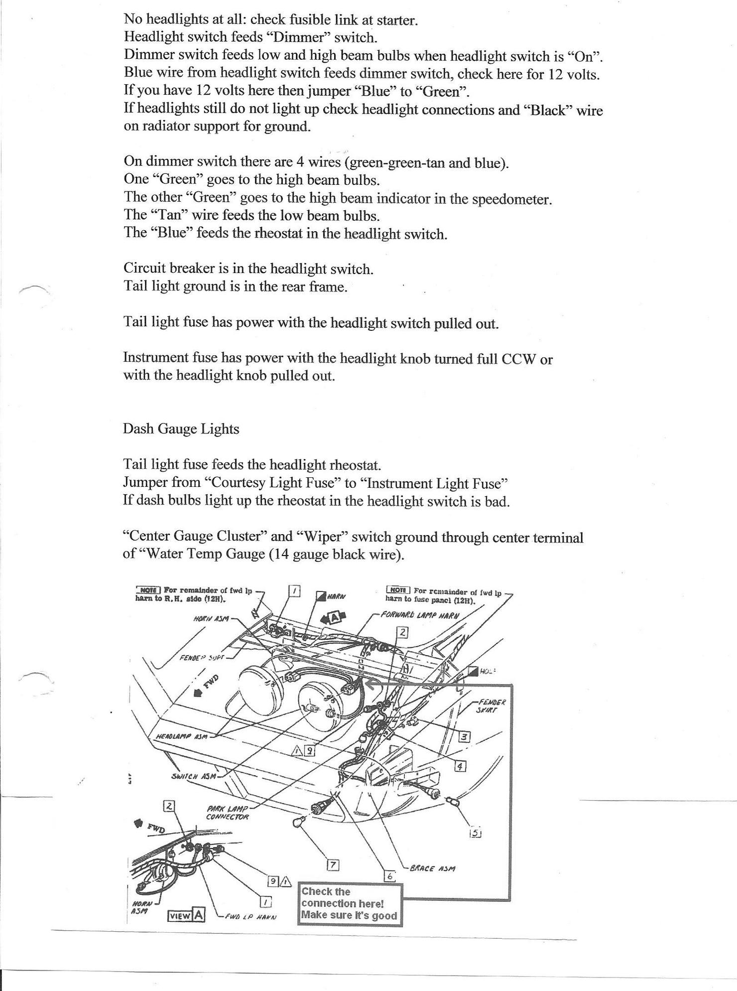

It's very unlikely that all the bulbs are burnt out although anything is possible.
Here are a few things to check, if this is overwhelming post back with your questions.

My main problem with the headlights not working was the rusty and corroded connections at the back of the bulb. Hopefully you just have connection issues with some burnt out bulbs if all four are not working. Could be the foot switch on the floor connections also. Other issues could be in the headlight switch itself. As others have said it is not hard to replace the bulbs....just takes a screwdriver to change them.
