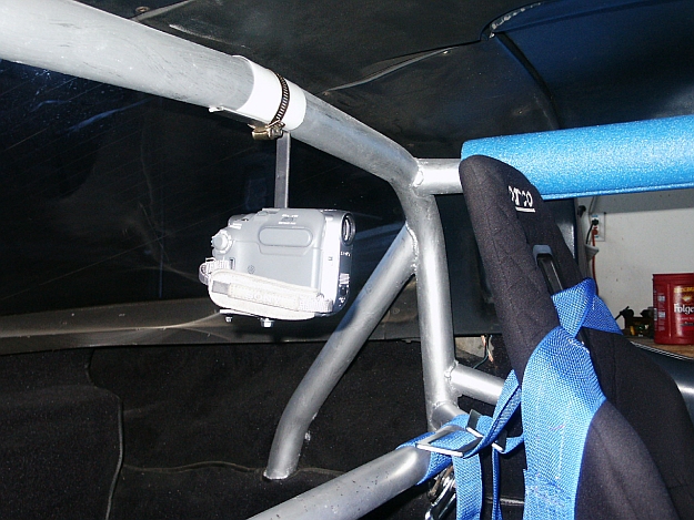

Do a search on my name and roll cages. I posted someone's beautiful cage. Mine was done by a Porsche shop and they had never done a vette before. So it's got some bad points
I took out the carpet, insulation, and seats. They used a hole saw to get to the frame rails. I wanted a heavy duty safer cage so I used 1 3/4 inch DOM .130 or something wall. I had a shop install bubble wrap interior heat shield in the floor and console along with flame retardant short pile carpet

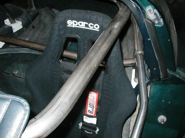

The seat width is dictated by how wide the angled shoulder bar is for clearance. Read the rules on where it has to be placed for the side impact parts of the cage. I'm kinds small 5'10" 168 pounds. So I bought Sparco fiber seats of my size and made custom mounts flat on the floor for helmet clearance. I'm also clear back against the batter box. So my feet are straight forward.
