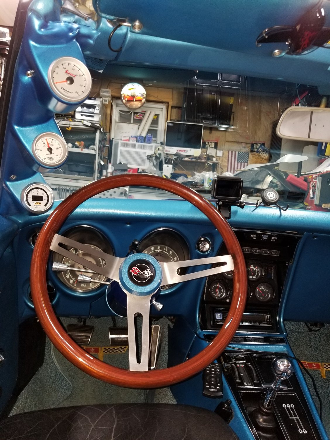

I had the original 16" 67-68 wheel in my 68 and had to add the Ididit column to get underneath it. The tilt doesnt help to much and then some a pillar gague mods had my hand hitting them so I wen tto the new 14" mahogany wheel they just released this spring. I like it but for some reason the wood makes my hand sweat.
