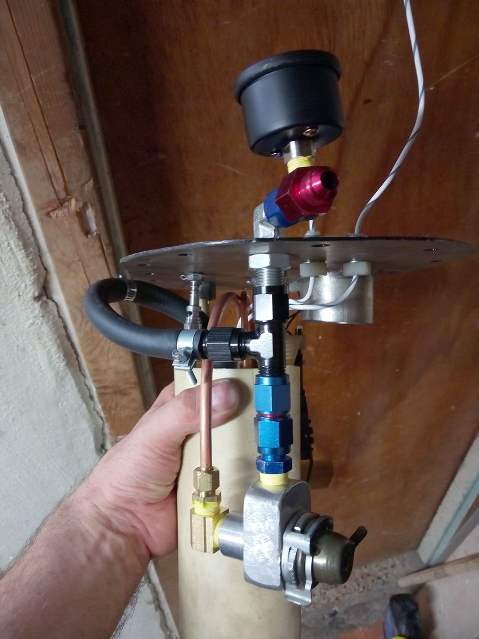

I built my own setup since there is not turnkey solution for '76-'77.
Details here with an update a couple posts later.

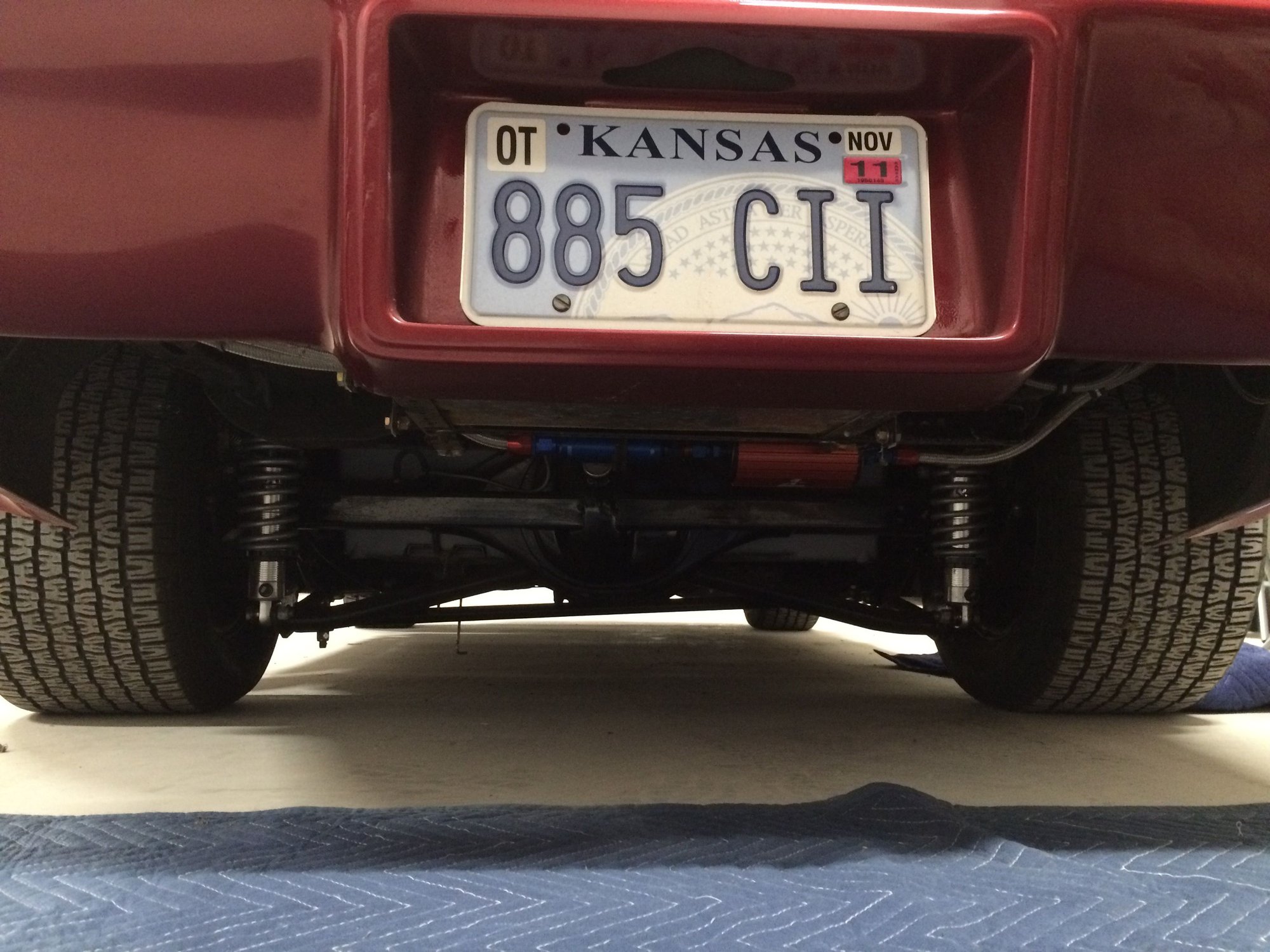

I had a sump welded into the stock tank but it didn’t work very well since the sump was on an angle and wasn’t the lowest point of the tank. I ended up gutting the rearend completely and Installed a 15g aluminum tank.
Old Nov 5, 2019 | 05:27 PM
Corvettedave02's Avatar
Corvettedave02
C3. 427, 4-link, c7 z06
Joined: Sep 2019
Posts: 997
Likes: 207
Pics
