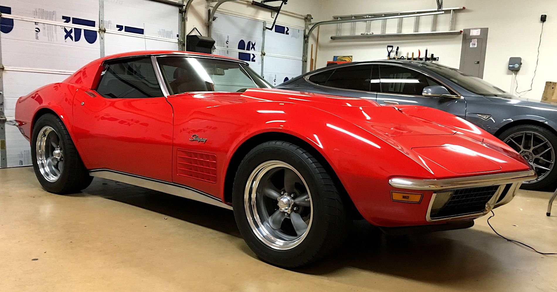

How about 17"? These are American Racing CL205. 17x8 with 4" back space. Bolt-on, clears stock and big brakes. No spacers.

On the picture of your vet with the 17in American Racing wheels CL 205, 17 by 8 with 4 inch backspace, were you able to put the 17 by 8 on the front and the rear and what what is the tire size you were able to use on the front and rear I might have to go this way did it change your overall height much as compared to the 15 and did you have any problem at all with any scrubbing when you we're turning

Yes, I have 17x8 front and back. Tires are 255/50-17 all around. I did have to trim the front fender lip to clear when turning, which is actually what the factory did on later C3s with the optional 255/60-15 tires. If you don't want to do that you can step the front tires down a bit to either a 245/50-17 or a 255/45-17.
The 255/50-17's are the same 27" overall height like stock and the ride height is same as stock.
With decent tires (I have Nitto 555's) you'll be surprised how much grip you have compared to any available 15" tire, especially when braking.

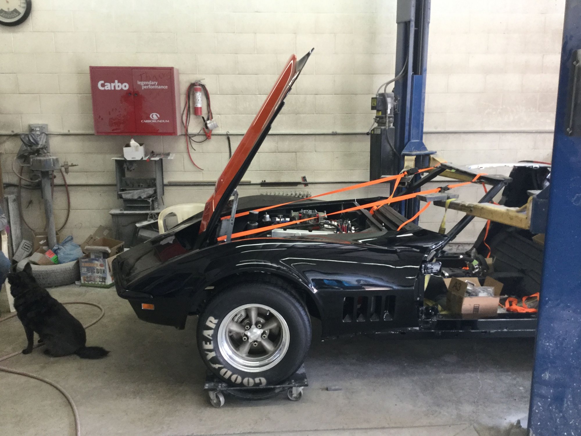

Torque Thrust D will fit being D stands for disc brakes. Torque Thrust Originals will fit w/ spacers.Heres my TTO 15x8.5

Those Torq Thrust D's look great on your vet thanks for the info were you able to put 15 x 8.5 on front and rear what size tires were you able to fit on the front and rear, appreciate all your info and help

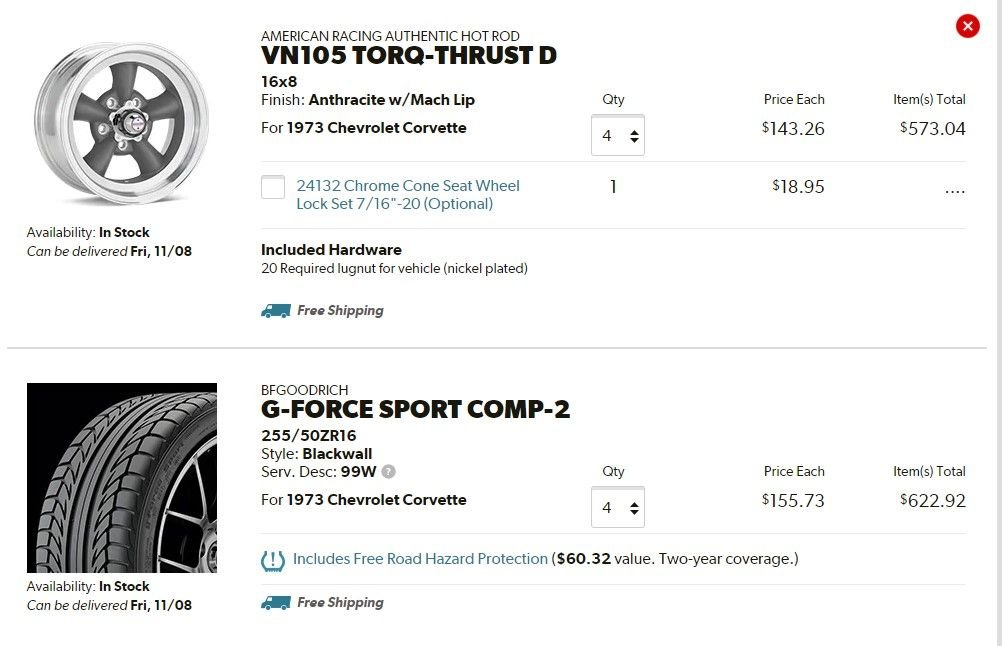

As others have stated, the new Torq Thrust D will clear with no spacers.
By the way, you can get the TTDs in 16x8 with -12mm offset same width and offset as the stock wheels.
