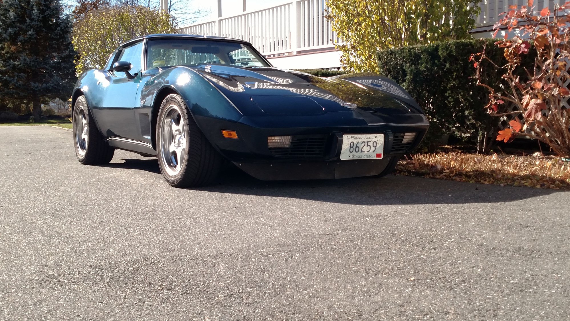

Below is how I have transformed my car, one change at a time over 35 years, into the 78 L-82 355 today that rides so well (firm but not harsh) and handles like a modern sports sedan (not quite like my 10C6Z06) with excellent steering response and suspension control......
Front:
550 lbs front coil springs/1 inch lower than stock-
1 1/8 inch front sway bar (OEM Bar size)-
poly upper and lower control arm bushings-
Bilstein HD shocks-
Front Spreader Bar-
Custom blueprinted/rebuilt OEM steering box- GTR 1999-Gary Ramadei-
This modification will make your OEM box about as good as it gets with the OEM steering and very close to a borgeson.....not quite but close
255/45/17 ZR ultra high Performance tires
Rear:
360 monospring-
Bilstein Sport shocks-
OEM Style Rear Sway bar (not the aftermarket type bars. I highly discourage NON OEM/GM style rear sway bars)-7/16 or 9/16 or 3/4 inch (I have this one replacing the stock 7/16 inch bar)-
Competition adjustable strut rods with heim joint ends-

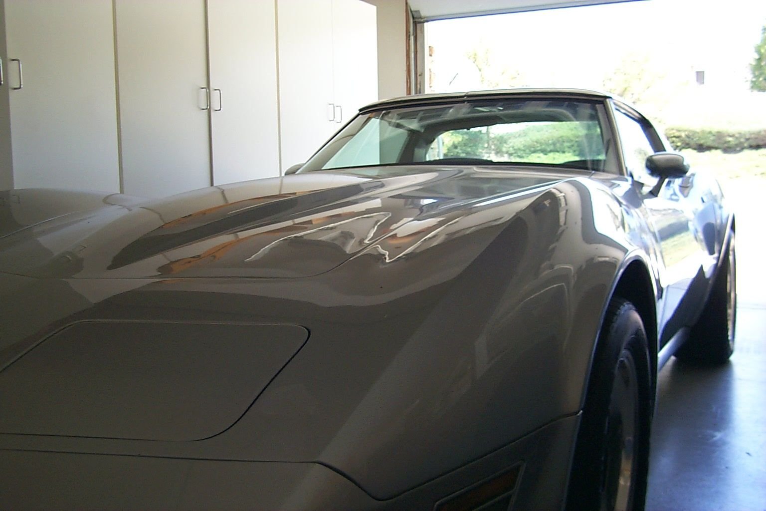

Its fun thinking back at all the suspension upgrades installed over the years on my high mileage 81. I haven't driven it in half a decade now which makes me a bit sad. The car still has inherently sloppy steering due to the pitman/idler arm design but the car drove like it was on rails with complete confidence. That package includes a lot of the items needed and I agree with others, it looks a bit overpriced.
I started with poly bushings all the way around. Everything including all suspension arms, bars, shocks, and steering parts. Anything I could find basically.
Rebuilt the rear wheel bearings at least 3 times and replaced the HD grease able u-joints with zerks a time or two as well.
Once, I believe it was the left diff yolk wore out and negatively affected everything. I can't remember exactly, just that it was an expensive time consuming repair.
Replaced the steel rear alignment shims with SS. This was probably unnecessary but did make it easier for the alignment guys.
Replaced the rear lower strut rod with something adjustable. This was also unnecessary but it did eliminate a problem I had often with the rear alignment cam's slipping after hitting things like unexpected pot holes.
Installed Bilstein Sports. What an incredible difference. I've tried everything from KYB's to adjustable Koni yellows and found them all unsuitable for me.
Added 7/16" rear sway bar (front is still stock). The 81 apparently came with no rear bar at all and I found this out quickly.
Replaced the front sway bar end links with quality bolts. I snapped the stock bolts clean off more than once which was scary.
Replaced front springs with Gymkahana 550#. The rear is the stock composite that came with the 81. This made a huge difference, those old stock springs were too soft and sagging badly.
Replaced lower ball joints. This was not exactly needed at the time but with everything disassembled it made sense.
Replaced the front spindles. This was not expected and the bearings had worn a ring around the axle shafts.
Replaced the steering idler arm with quality HD replacement. I replaced this often, that steering design is awful.
Replaced the tie rod ends, they were oddly worn out at one point and were actually clunking.
Replaced the steering ram with new, not rebuilt. The stock one had severe wear on the shaft near center and tended to stick there. 2 or 3 rebuilt units I returned for the same reason.
Replaced the power steering control valve and hoses. The hoses were old and the control valve leaked a bit (or maybe it just didn't work, I forget why exactly)
Installed SS brake lines and slotted aftermarket iron rotors and decent street pads (I don't remember the manufacturers, it's been a while).
Rebuilt the brake calipers more times than I can remember. Always kept them stock and I still have to pump the brakes weekly or they pee brake fluid all over. I considered the aftermarket o-ring design a time or two.

I notice you did HD front and Sport rear Bilsteins on your car ...did that come from trial and error or was there some sort of method to your madness !!??
Old Nov 9, 2019 | 09:13 PM
jb78L-82's Avatar
jb78L-82
Joined: Oct 2007
Posts: 7,453
Likes: 976
From: RI, Now Franklin/Nashville TN
Yes trial and error.
I originally had Bilstein HD's all around but found with the 360 monospring in the rear, the ride was too bouncy and not damped sufficiently in the rear only. Since the Bilstein Sports are 30% stiffer than the HD's, I decided to switch out the HD's in the rear only and kept the front HD's since with 550 front coils, I did not want any more stiffness up in the front. The result is a perfect combo for the rear 360 composite spring with the sports and 550 front coils with the Bilstein HD's....
