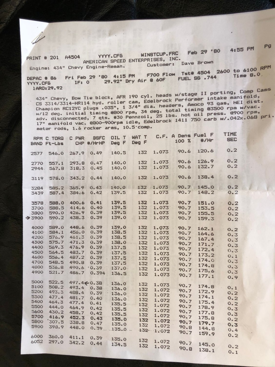

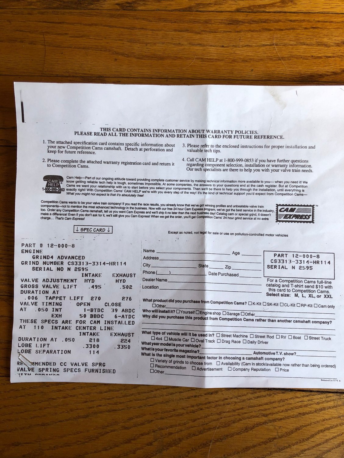

Flyboy I’m probably late to the party, but here is the dyno, build sheet, and cam card for my SBC 434. It has been a true street motor fom the start with 590 ft lbs at 3900 and 497 hp at 500. Overdrive automatic trans, stock stall converter and 2.8 rear gears. Currently being rebuilt for the 72 vette. Been a great street motor with great manners. Pulls plenty of vacuum. Lots of HP left on the table due to performer intake and carb (hood clearance). Maybe this can be helpful on some way
