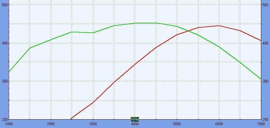

I absolutely get where you are coming from.
I just looked at your current 350.
Roughly 325 ftlbs at 1000 rpm.
Pretty soft tq at low end with that combo but feels strong upstairs at 2500 up.to 6000
The one step milder cam I mentioned is worth 25ftlb down low. even on the 350.
The 3.8-4.0" stroke is worth 50 ftlbs down low.
The 4.125" bore is worth another 25 ftlbs down low.
Goes up to 425 tq at 1000 rpm.
HP doesn't really change much from where you are now, it just happens 1000 rpm lower.
Resulting curve looks almost exactly like a BBC 427 390HP.
current 350:

Leigh,
The two graphs you posted tell the story pretty accurately, and show the fix I am looking for. I appreciate your efforts and posts. What would really be cool is seeing both curves on the same graph. What computer program are you using?
As usual, people begin to post comments that increasingly move the engine back to the high RPM engine I do not want. Happens every time. I think that guys who race cars, or build high RPM motors, simply do not consider a lower end torque a real engine. Some of them strongly believe their high RPM engine is what I need to meet my requirements. And one disadvantage I have is that I have never driven a strong low end torque engine. My 350 gets close to what I want, but only when I floor it. I read all the time about guys with LS5 early Corvettes about how the torque pushes you back in the seat down low, and it sounds fun to me. Speed is not my goal, as I drive on city streets, and curvy Pennsylvania roads. My wife's 4 cylinder Toyota Camry will go 90 mph,......if you wind it out, so what? My 2015 F150 with 5.0 V8 will go fast......if I floor it, so what? I think you understand my goal, and I appreciate your input.
