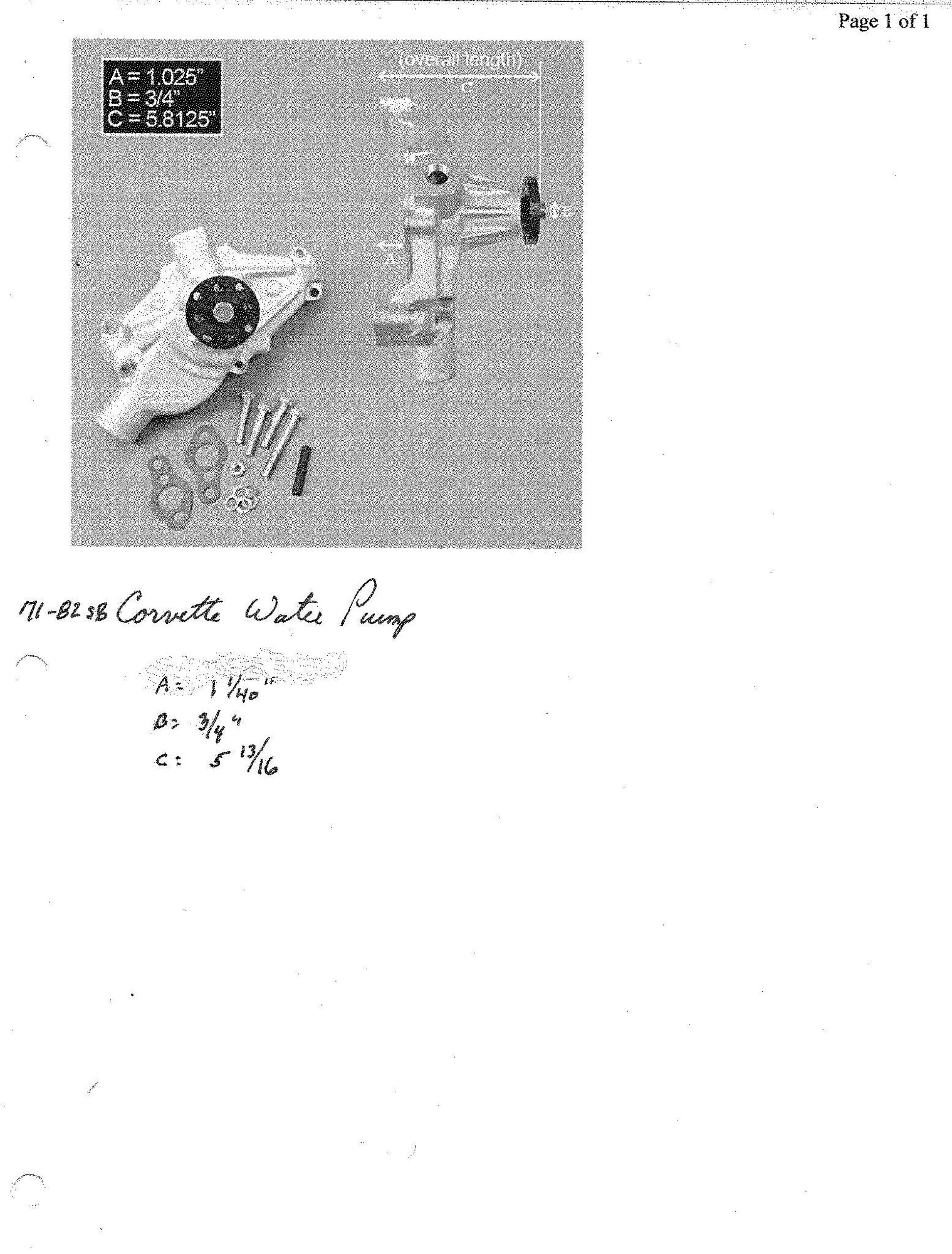

Here are the measurements:

The big hole in the top of the pump is 3/4-14 pipe (minor diameter is .974 or 59/64). The heater hose nipple threads are 1/2-14 pipe thread (minor diameter is .763 or 45/64).
https://www.summitracing.com/parts/sum-221102/overview/
https://www.summitracing.com/parts/r...-072/overview/
If you need the 90-degree fitting in the top hole for an L79 intake manifiold, you have to use a 2-piece pipe bushing to reduce it down to 1/2-14 pipe with the 90-degree fitting.
