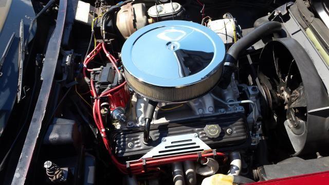

When I did an engine swap in my 77 I removed all of the original ac-heater system.
With the engine out of the car there was plenty of room to simply fiberglass the opening
in the firewall smaller, to the size required to install a non ac box from an earlier year.
Then I found the wire in the console that powers the fan all of the time in slow speed and removed it.
That's now my off position.
