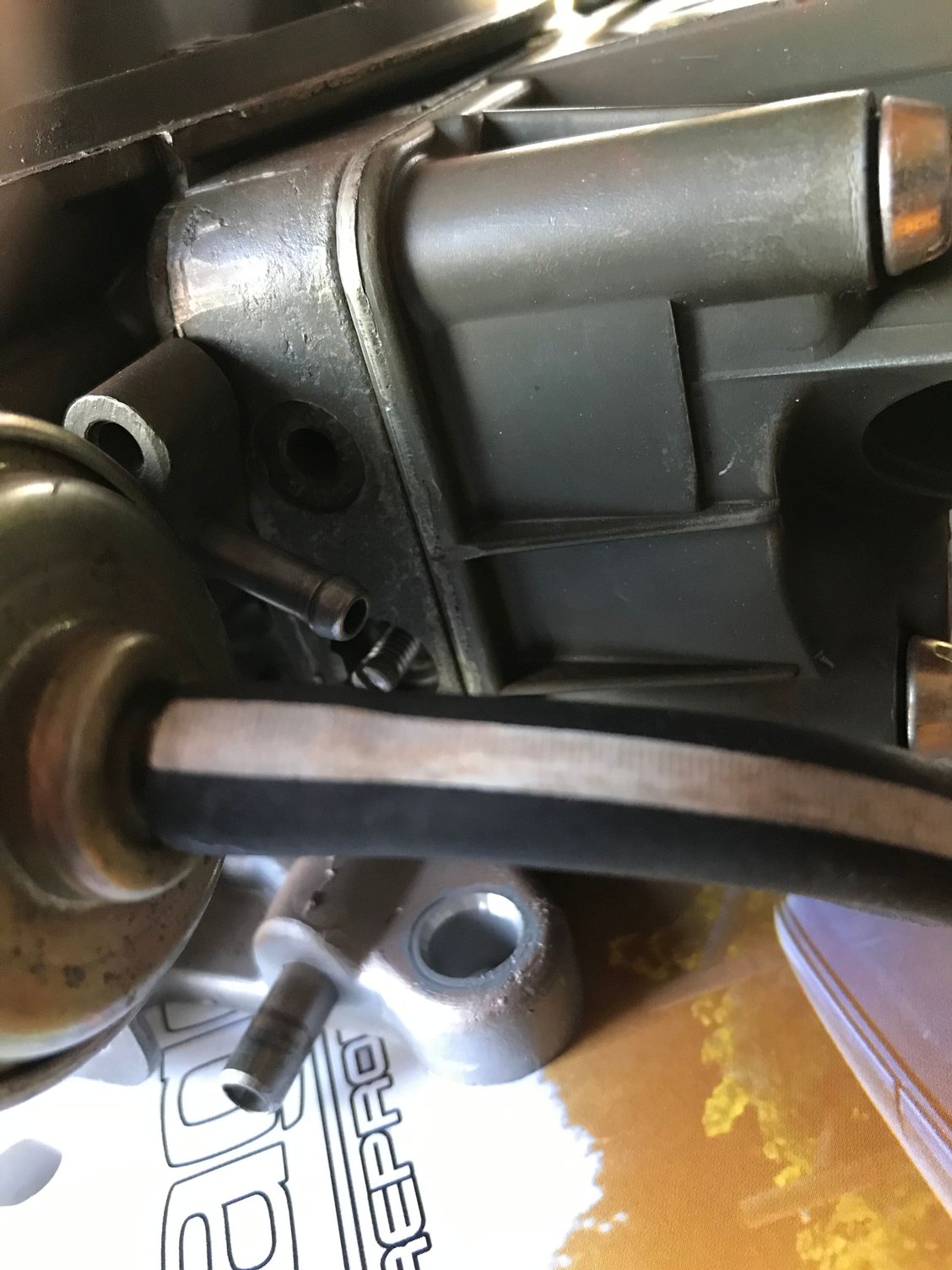

Thanks Lars. Makes sense. Here are the 2 ports in the center carb. One is in base plate. I am not sure which is manifold or ported vacuum.

The small one (upper) is for the Secondaries and won't be appropriate for the purge source.

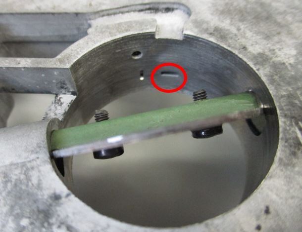

The nipple in the baseplate is almost always manifold vacuum. The nipple in the center of the carb is venturi vacuum to operate the secondaries, and cannot be used as a purge valve trigger. If you flip the center carb upside-down and look up the throttle bore, you should be able to see if it even has a slotted opening just above the forward edge of the throttle plates for ported vacuum. If it does, you can trace that circuit down and see if it would be practical to drill an intersection hole into that passage in the float bowl or the metering block.
Typical ported vacuum slot in the throttle bore just above the level of the forward edge of the throttle plates when the plates are closed at idle:
If you cannot locate, or create, a ported vacuum source, you cannot use the purge canister unless you changed it over to a late-model ECM-controlled canister with a solenoid-actuated purge valve. You could trigger the purge valve using a throttle position switch to assure that the purge valve only opens when the engine is above idle.
