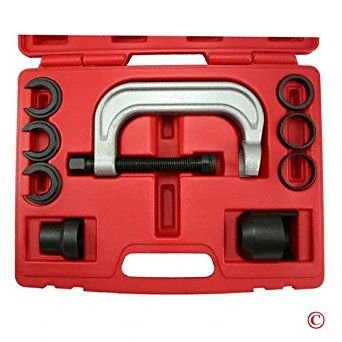

The above suggestions are good, but risk bending the A-arm. Spend about $60 and get the correct GM bushing tool. Several are available on ebay
might be able to rent tool from local parts store?
You can rent the correct tool from any O'Reilly, Autozone, NAPA or Advanced auto parts store.

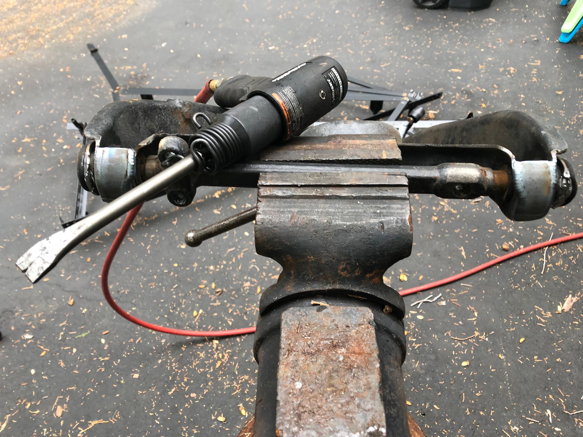

Air chisel around the perimeter of the old bushing flange runs them right out...
Like This
Once you get behind it slightly pry outward
