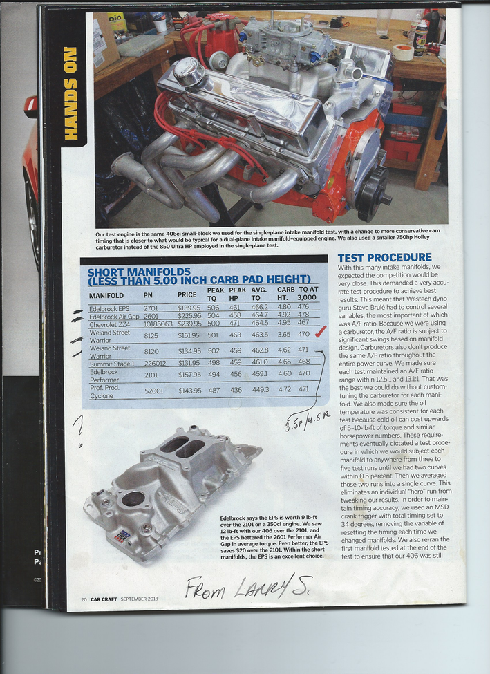

Weiand 8004 was succeeded by 8120 ... 8004 reputed to perform a bit better than E 2101
older height comparo
Intake Manifold, OE Cast Iron L-48 F = 2.69” R = 4.375”
Intake Manifold, Weiand ActionPlus p/n 8004 F = 3.50” R = 4”
Intake Manifold, Edelbrock Performer p/n 2101 F = 3.50” R = 4.60"
