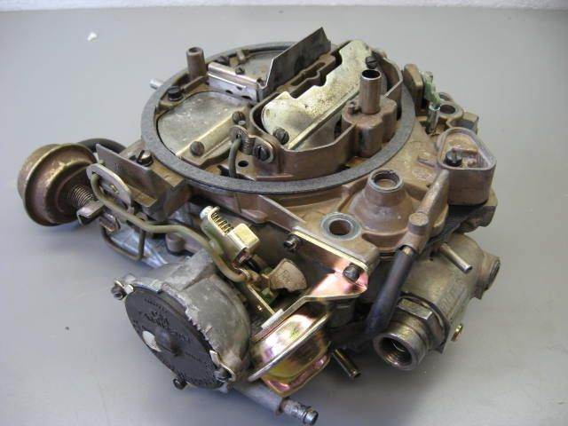

Here's what mine looks like and the location of the screw. yours is different? anyone know if this indicates mine is not the original carb?

Here are my thoughts why the rear pull-off and linkage was used on the 75. 1976 and later Corvettes used a vacuum thermo sensor inside of the air cleaner to keep the fresh air inlet closed drawing in only Warm-Hot air from the exhaust stove pipe, once warm the sensor changed state shutting off vacuum and exhausting opening the cold air intake diaphragm on the air cleaner. That sensor uses the same vacuum source from the throttle plate as the rear pull-off did on the 75. I think as far as Corvettes, 1975 was the only year the rear pull-off was used.
Yes, I believe the same front choke style pull-off was used on the 75 but it just served a different purpose. If you removed the rear pull-off and linkage and capped the vacuum source from the throttle plate could you adjust the choke plate opening distance on a 75 with that screw, sure. Right, Wrong???
That is the correct, original configuration, and the screw you have circled is the correct adjustment screw for choke opening adjustment. Here is a correct, 1975 Corvette carb showing the adjustment screw:
For a complete step-by-step procedure for adjusting the choke on the stock carb, just send me an e-mail request for the paper.
Originally Posted by PCK1221
My car does not look like that.. I'll have to snap a pic. That is interesting.
If your carb does not look like the carb I have pictured above, you have the wrong carb for the car/engine. Post a photo and I'll tell you what you have.
