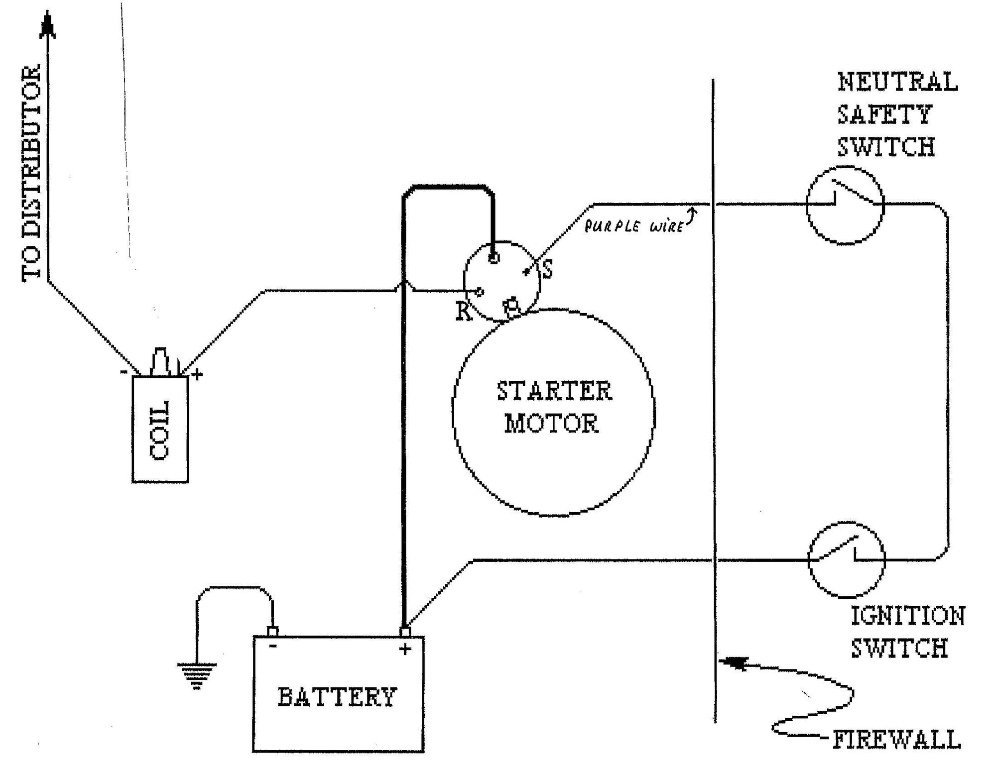

To test that the starter works jumper from the main large battery connection to the 'S' terminal.
Next, have a helper turn the ignition switch to 'START" and see if you have 12 volts on the 'S' wire.
If not then check that the neutral safety switch is adjusted properly.
Here's a simplified starter schematic.
