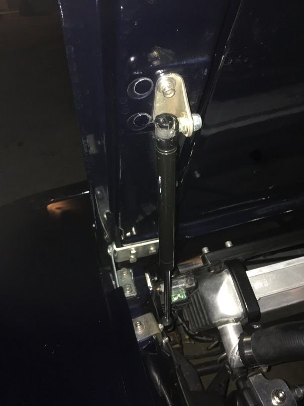

I'm not sure what the hood prop looks like on a C3 but I put a gas version on my C2. Autozone Mighty Lift E9512. Less than $25 and comes with the ball sockets for the ends. I just drilled out the rivets on both ends of the stock hood prop, installed end brackets with the *****, and latched on the strut. Been on the car for a few years now. Still works.

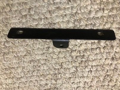

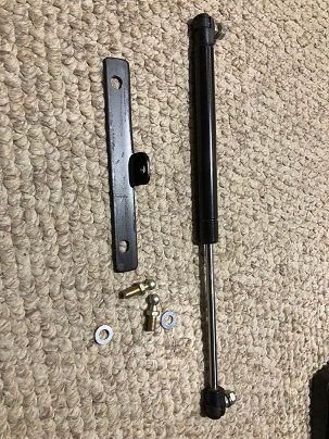

Old Jan 11, 2020 | 10:45 PM
The Punisher's Avatar
The Punisher
Joined: Oct 2006
Posts: 2,938
Likes: 173
From: hebron IL

I made my hood bracket out of angle iron for my 77 and the strut was from autozone, pylon lift kit, part # 8200.
