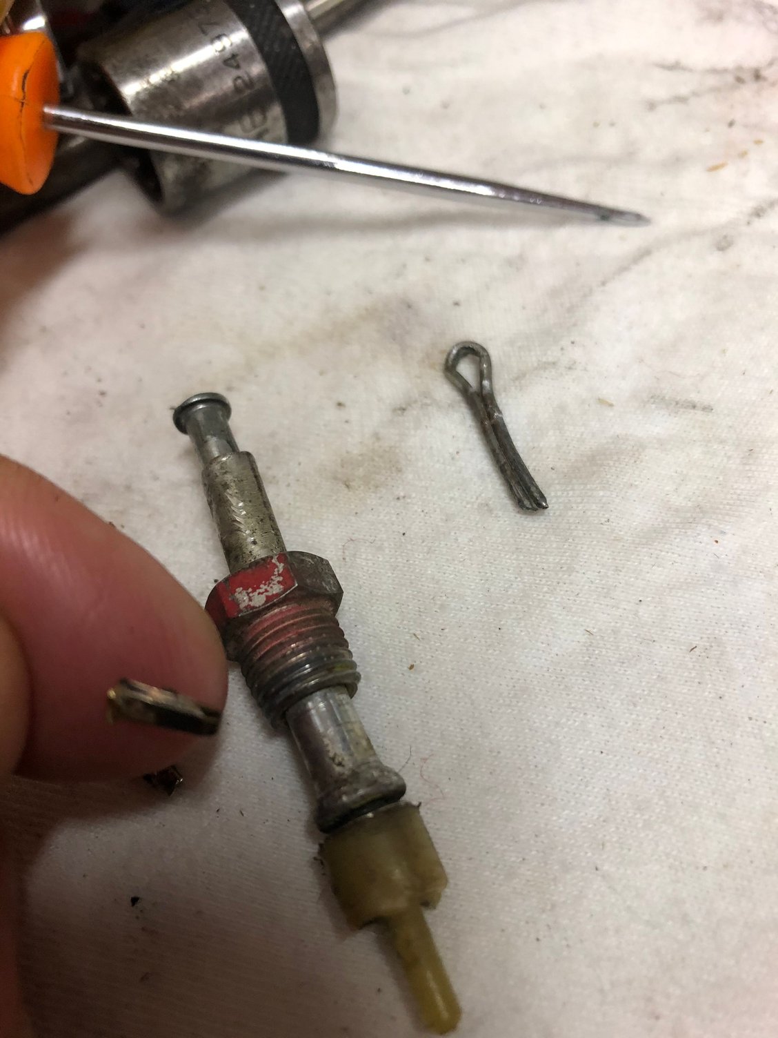

Originally Posted by Pmccooey
Bend the pins? No, you should be able to insert them in and then tighten down the threaded nut.
so just push them into the plastic nut? The broken ones I pulled out looked like they were bent on install

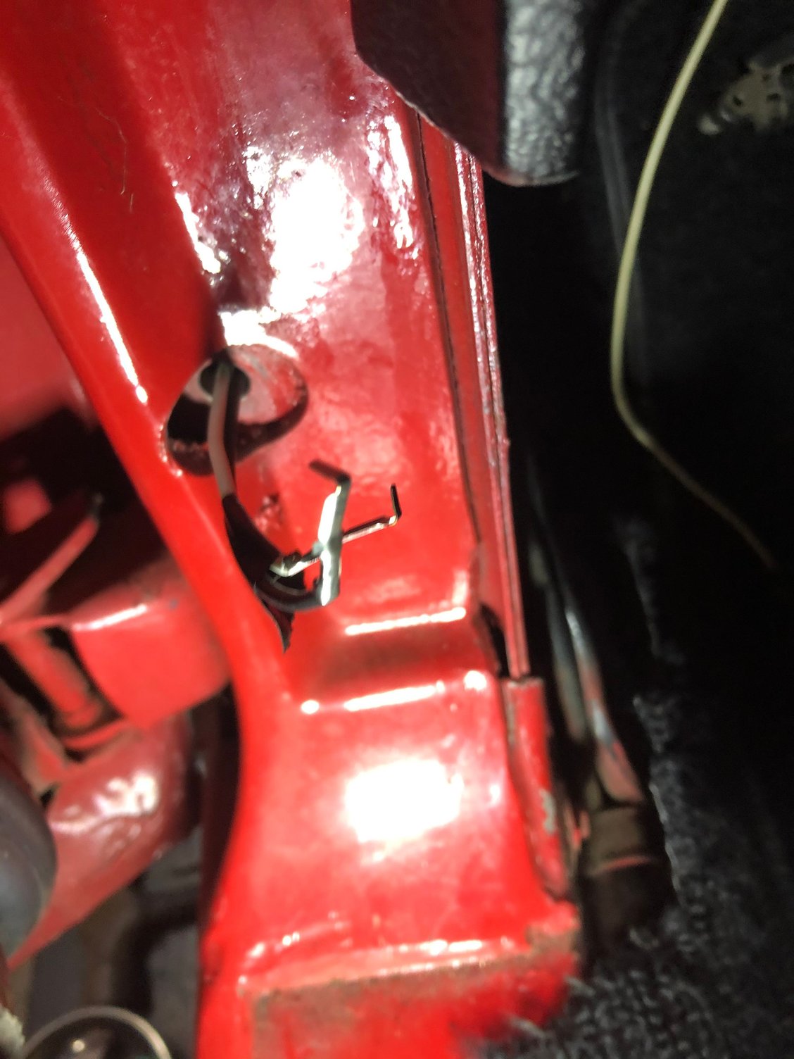

Here’s what I’m looking at
Old Dec 26, 2019 | 08:42 PM
PGPierce's Avatar
PGPierce
Joined: Jan 2014
Posts: 45
Likes: 7
You need to view Ecklers they will have the correct part or Zip Corvette. Just google them.
Old Dec 27, 2019 | 07:26 AM
JBrooke825's Avatar
JBrooke825
Joined: Nov 2002
Posts: 1,787
Likes: 261
From: Blue Bell PA
2018 C3 of Year Finalist
Those pins have a little tang on them that bites on
into the plastic of the switch, you’ll have to get new pins and attach
them to the wires. I just got mine from Zips. Very small and not easy
to crimp with out a crimper that was made for them. I don’t think they
are available anymore. Buy extra and practice. Good luck.
